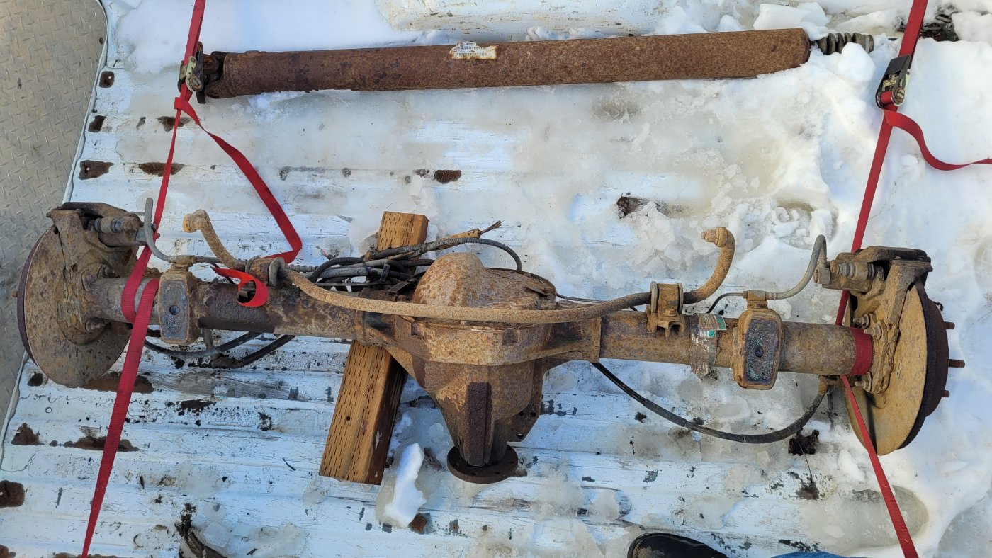

Got 'er and the driveshaft, so don't even have to buy the stupid companion flange. Looks like the tag on it does say 4L10 (4.10 limited slip), but I'll pull the cover and confirm. The guys who took it out went way less hack than I would have. Saved the ebrake cables and everything. :laughing:

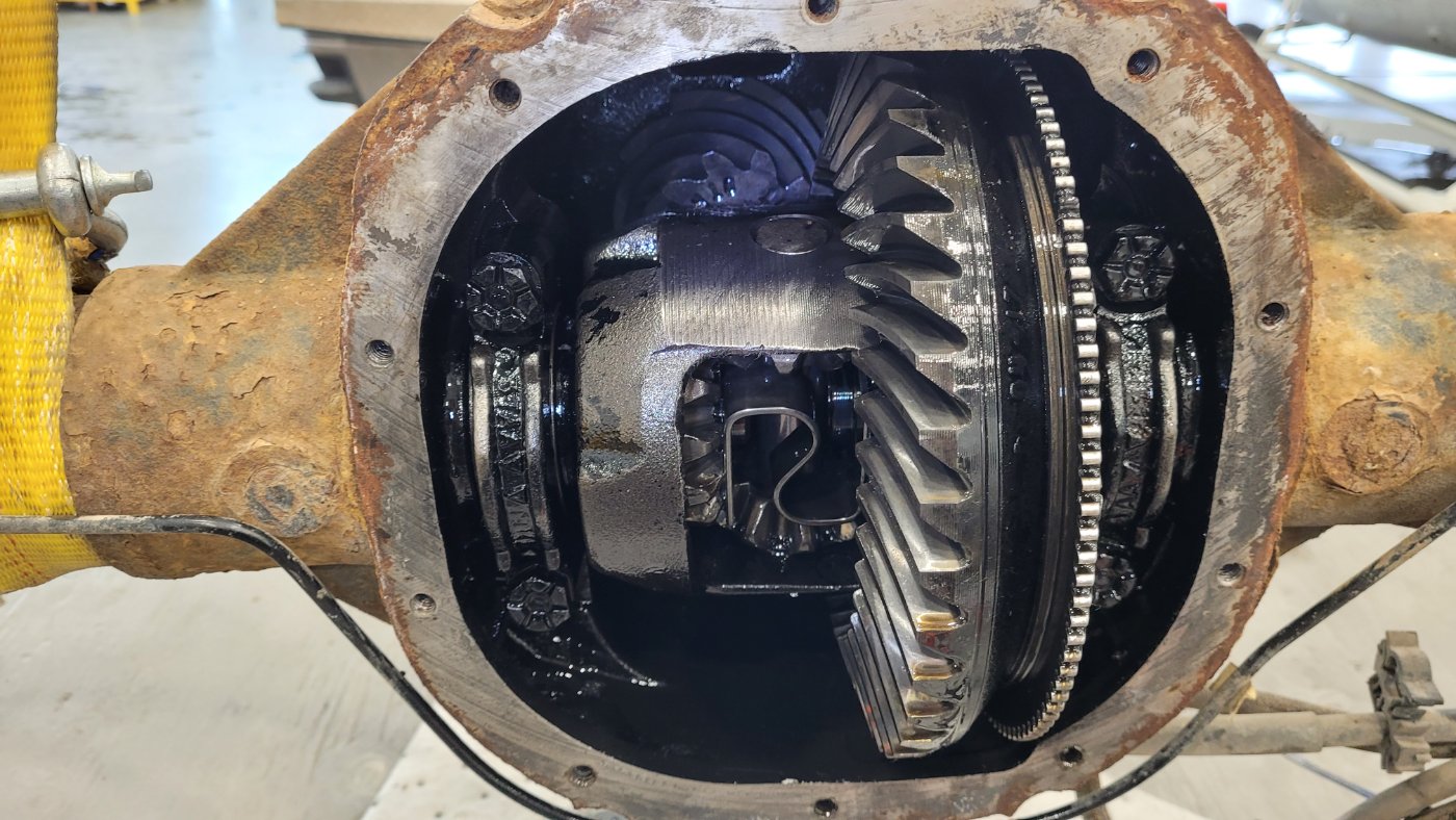

The 8.8 is indeed a 4.10 limited slip.
It'll need some love but looks pretty decent. Good enough for this old junk.

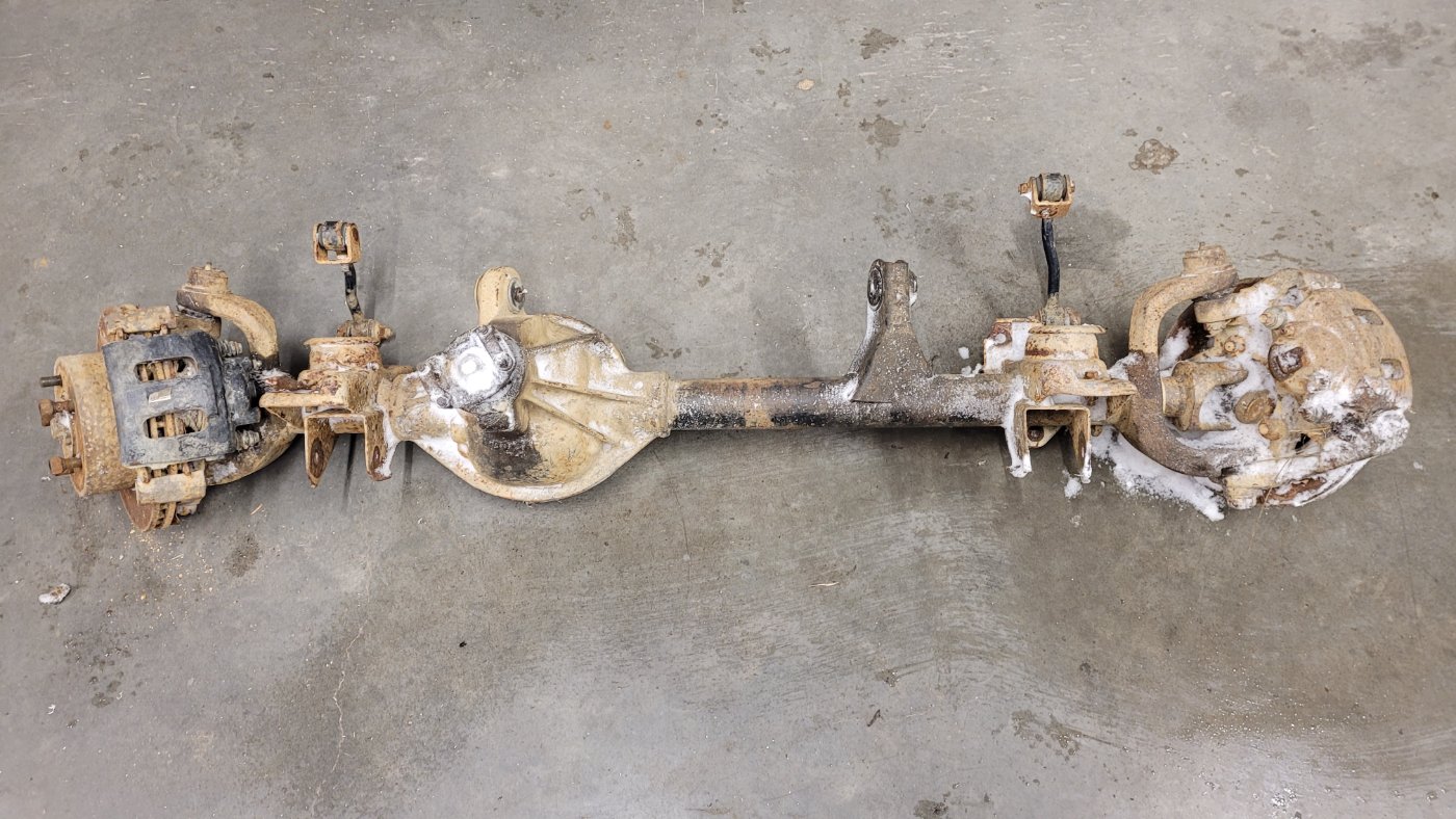

I have exchanged currency for garbage.
BOM looks like it's a 94-97 XJ axle. Which is good, it should have the newer (normal) knuckles and whatnot. Haven't pulled the cover to check ratio, but as per seller it's 3.55, which is likely as that is the most common XJ ratio.

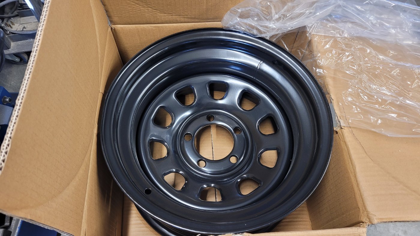

Found some wheels for $100/each. 15x8 3.75 BS. Screaming deal compared with everything else I found that was actually in stock. Gone are the days of $60 wheels.
Scoobienorth
Posts: 1045
Joined: Sun Sep 22, 2019 4:43 pm
Location: Enderby
Has Liked: 77 times
Been Liked: 72 times
Re: I bought a TJ because why????
Post by Scoobienorth »
That’s a screaming deal. Most I’ve seen are a lot more than that

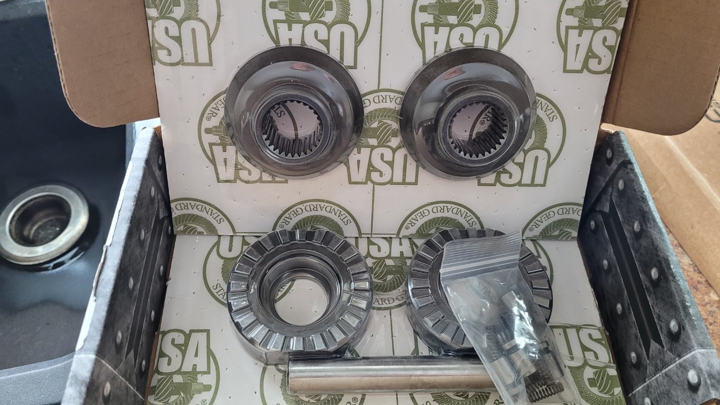

It's so cute. It's like a locker for a real axle, but only half the size.

Now hurry up and install it and see how it works. Not that I’m in a hurry. I’m still out sick and unable to pull wrenches. I got a real bad break with this thing
Scott Cee AKA 2drx4
Posts: 2142
Joined: Mon Sep 16, 2019 10:59 pm
Location: Prince George, BC
Has Liked: 157 times
Been Liked: 52 times
Contact:
Post by Scott Cee AKA 2drx4 »
Scoobienorth wrote: Sat Mar 02, 2024 3:25 pm Now hurry up and install it and see how it works. Not that I’m in a hurry. I’m still out sick and unable to pull wrenches. I got a real bad break with this thing
I've got one in the 60 front in my XJ and it works nicely, no issues. Can't even hear it clicking over all the other horrible noises.
