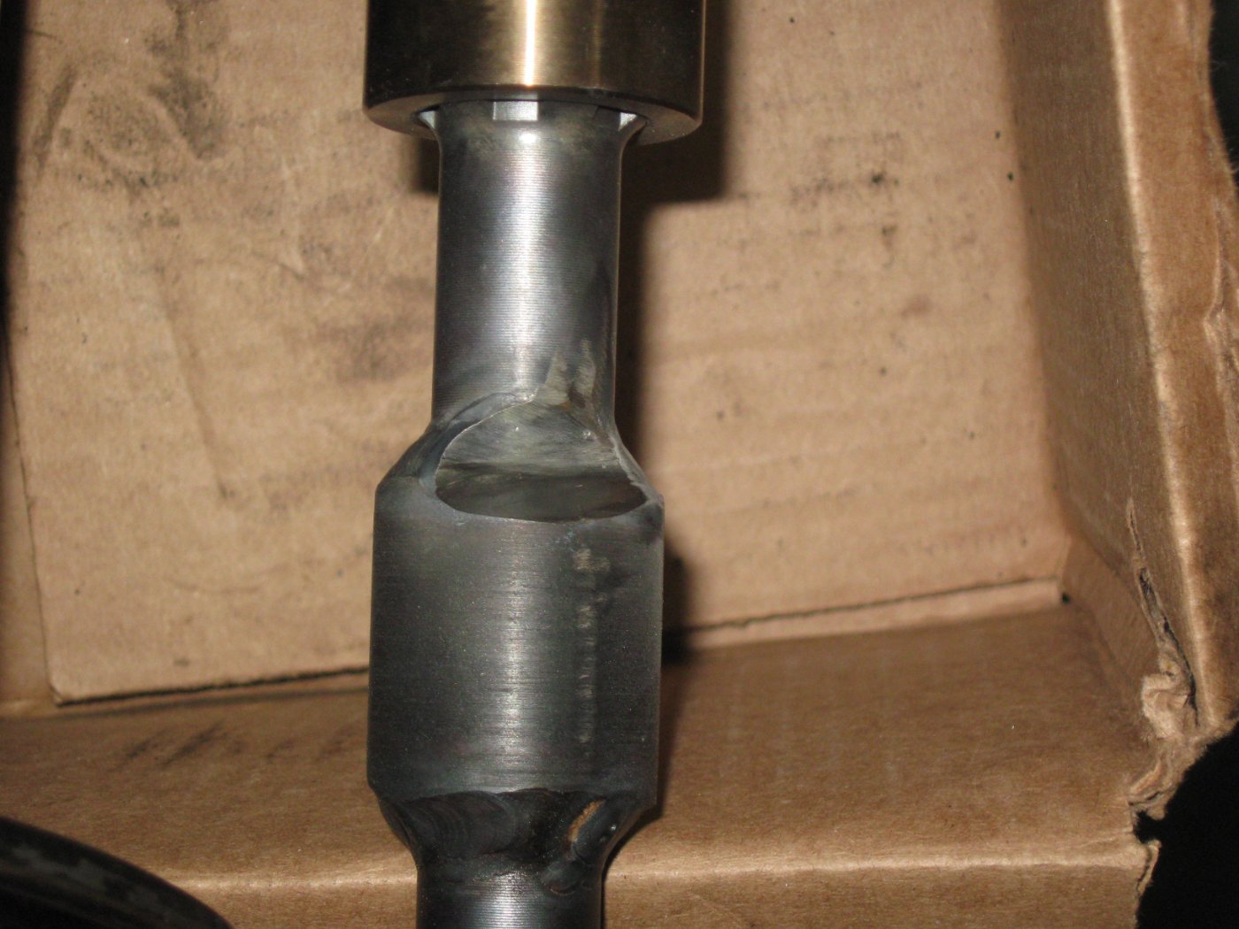

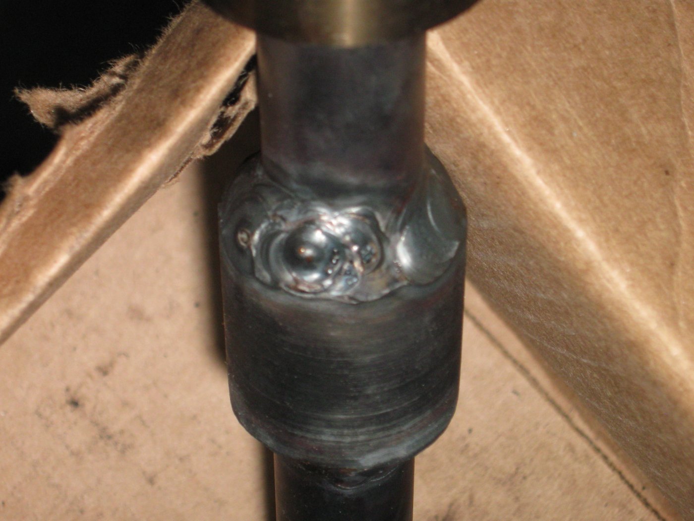

that said, if you really want to get parsnickety, it depends on the joint and the environment. the shielding gas is there to create a bubble free of oxygen to keep the molten metal from combining with the free oxygen and thus being unable to stay in one piece. it will turn in to porous nonsense. this is a bad picture, but you can kind of see a couple of the holes in this weld. the second picture is how far i had to grind to get through all the holes. This is just from a tack weld without enough gas causing instant porosity, then just welding over the top about 4 passes. the separated metally bits don't float out, they are essentially rocks. This is bad, if you see that, grind it out right away and start fresh.
