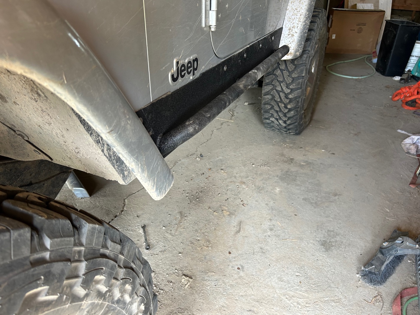

Those rocker guards look pretty decent for the money. Tempting to grab a set to cover up the one rust spot in my tub, honestly.
I think Smittybilt is basically pulling out of Canada now. So if you want them, they may not be available later.

Scott Cee AKA 2drx4 wrote: Tue Aug 20, 2024 8:43 pm Those rocker guards look pretty decent for the money. Tempting to grab a set to cover up the one rust spot in my tub, honestly.
Didn’t know about them pulling out. Reality of where I live and the cost of steel I’m not saving much by doing it myself. And it’ll be forever before I get anything done like that. As much as I want to grow my skills and do stuff better , some stuff just isn’t worth it. I can strip these down and powder coat it something better and it’ll be done in a few hours

They are decent enough material, on par with what I’d have built. The cuts at the end don’t really line up with the flares well, again much like I’d probably build. The powder coat seems heavy so I didn’t redo it to save time, then I drug it a tiny bit on the floor and it scraped off fairly easily so I mine wind up redoing it at a later date.

Looks okay from that angle. At least it doesn't stick out too far.
The textured powdercoat on the bumpers I bought from them (for my orange JK, way back in the day) did fail after a few years of rock chips. I suspect that is the same textured stuff.

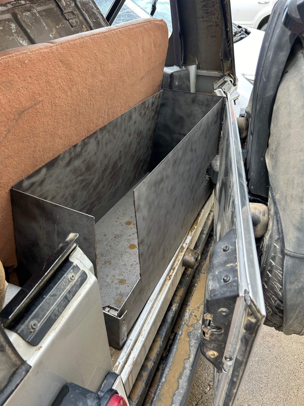

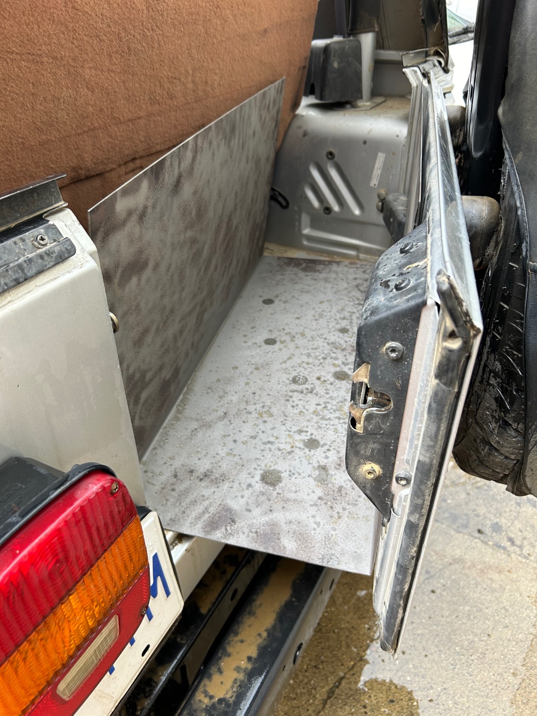

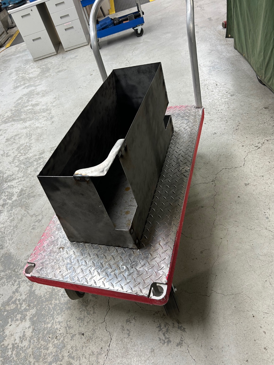

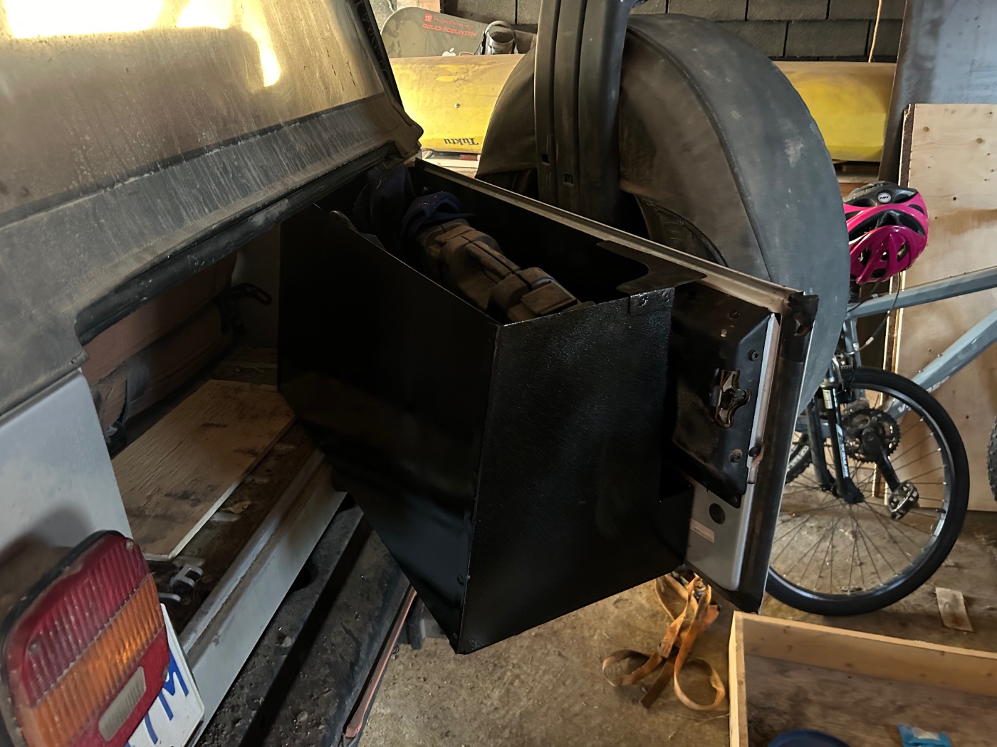

Got some time at work and some motivation to get this project started. It’s ready to weld out tomorrow. I used 16 gauge because the millwright at work wanted 1/8 plate. But I should have used 18 or 20 gauge. It’s pretty heavy. I may put some strategic speed holes to lighten it up once it’s built. Cutting around the hinge and latch kinda messed me up and it’s not super clean but once it’s got stuff in it you won’t see it. I'm planning on using rivnuts to hold it to the door, not sure how many. 8-10 probably. I’ll use some plywood on the floor of the Jeep to shim the toolbox tight so when the door is closed it won’t hold any of the weight.

That would have been absurd to make that out of 1/8". :lmao:

Scott Cee AKA 2drx4 wrote: Fri Sep 20, 2024 4:25 pm That would have been absurd to make that out of 1/8". :lmao:
Millrights with a plasma table make some heavy stuff. That’s as light as he works with. Even at 16 gauge with it welded up and the corner gusset on this is really beefy. We’ve got a 1 1/2” annular cutter bit for the mag drill press that I might put to work and knock some material out of this where it won’t matter

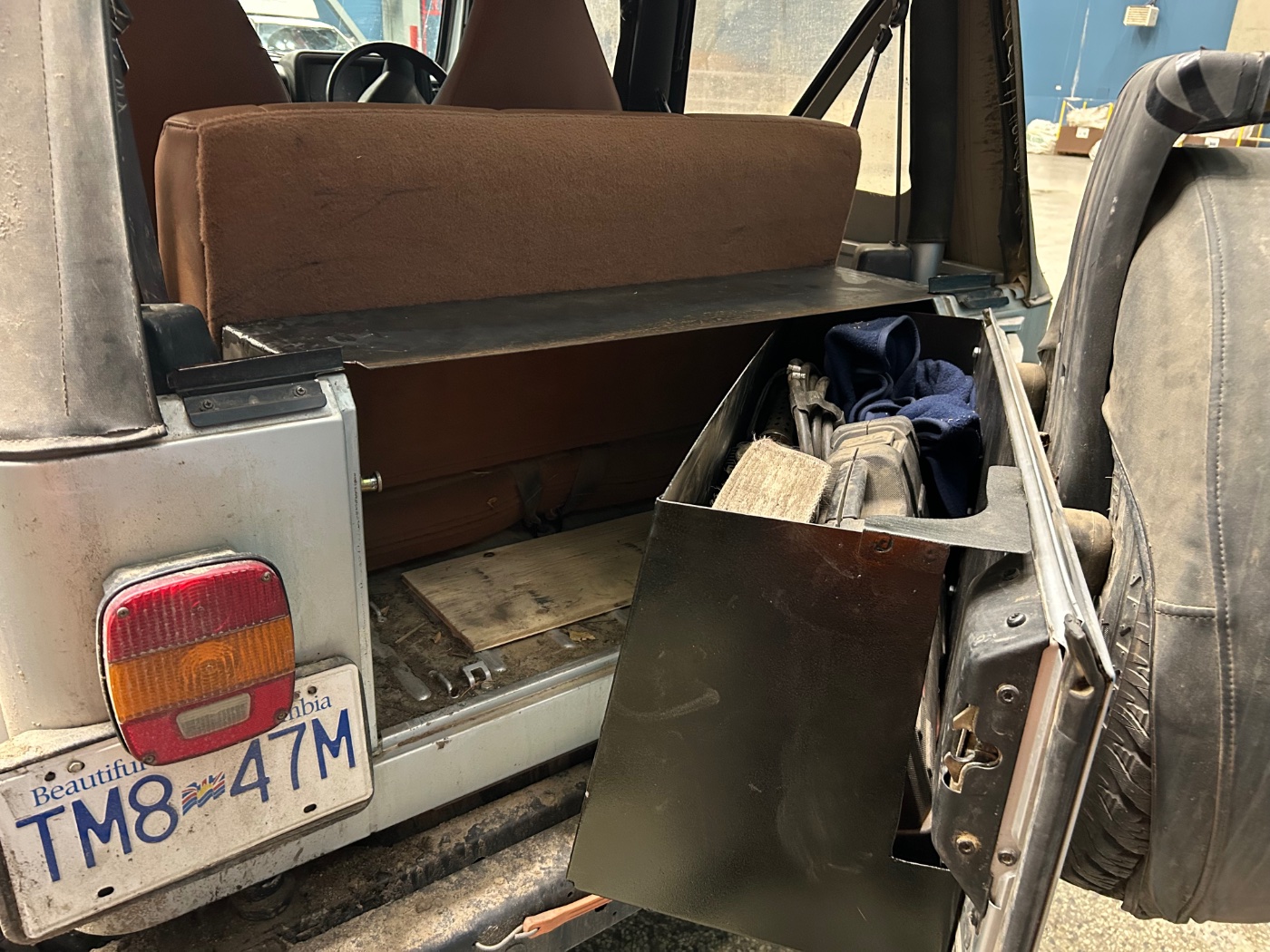

Tj storage box is mounted. My rope and strap aren’t in the box but I added a tool kit that I previously didn’t have room for in the pile I had strapped in. Seems a lot easier to use and put stuff in and out. I need to make the shelf/lid for it yet but -20 and doing it outside is slow going. I used 8 -8mm nutserts through the sheetmetal to hold it but it only supports weight when the door is open. I have a piece of plywood under the box on the floor as a shim to hold the box tight when the door is closed so I’m hoping it’ll hold and not crack or pull through the door

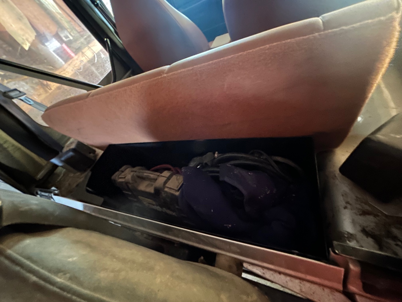

Almost done. Can finally see what I was wanting. The cover is removable with a bit of work, or will be with the door closed. Just need to rivnut the shelf down and drill some tie down holes and powder coat it
