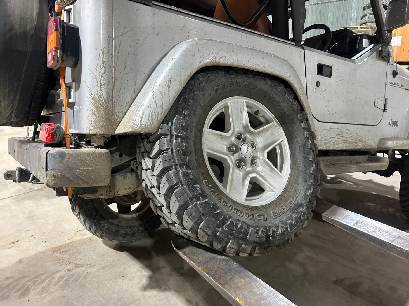

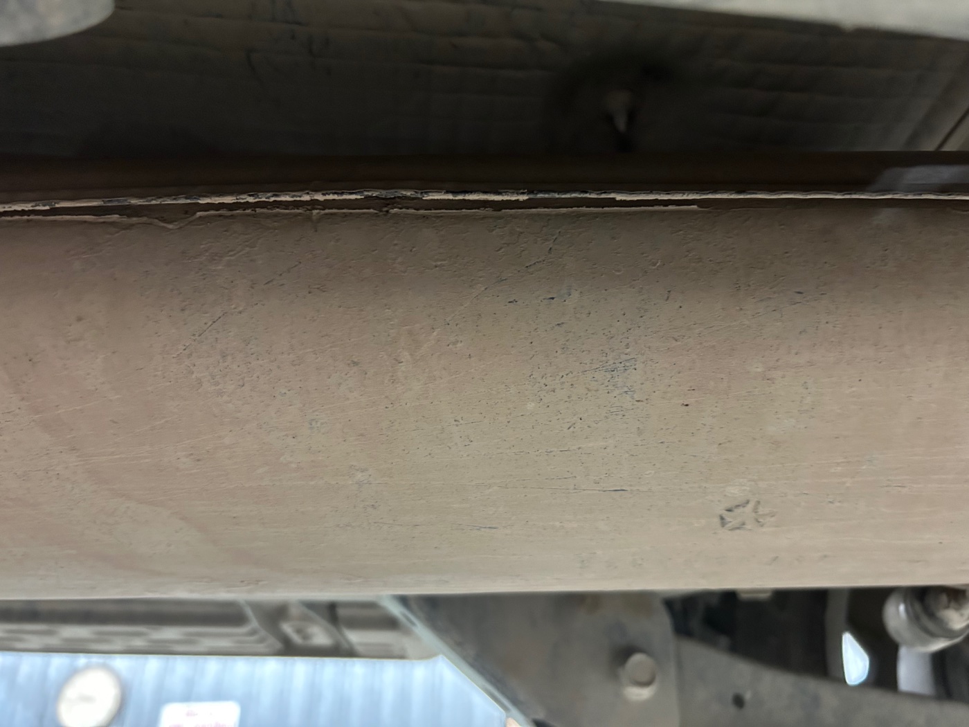

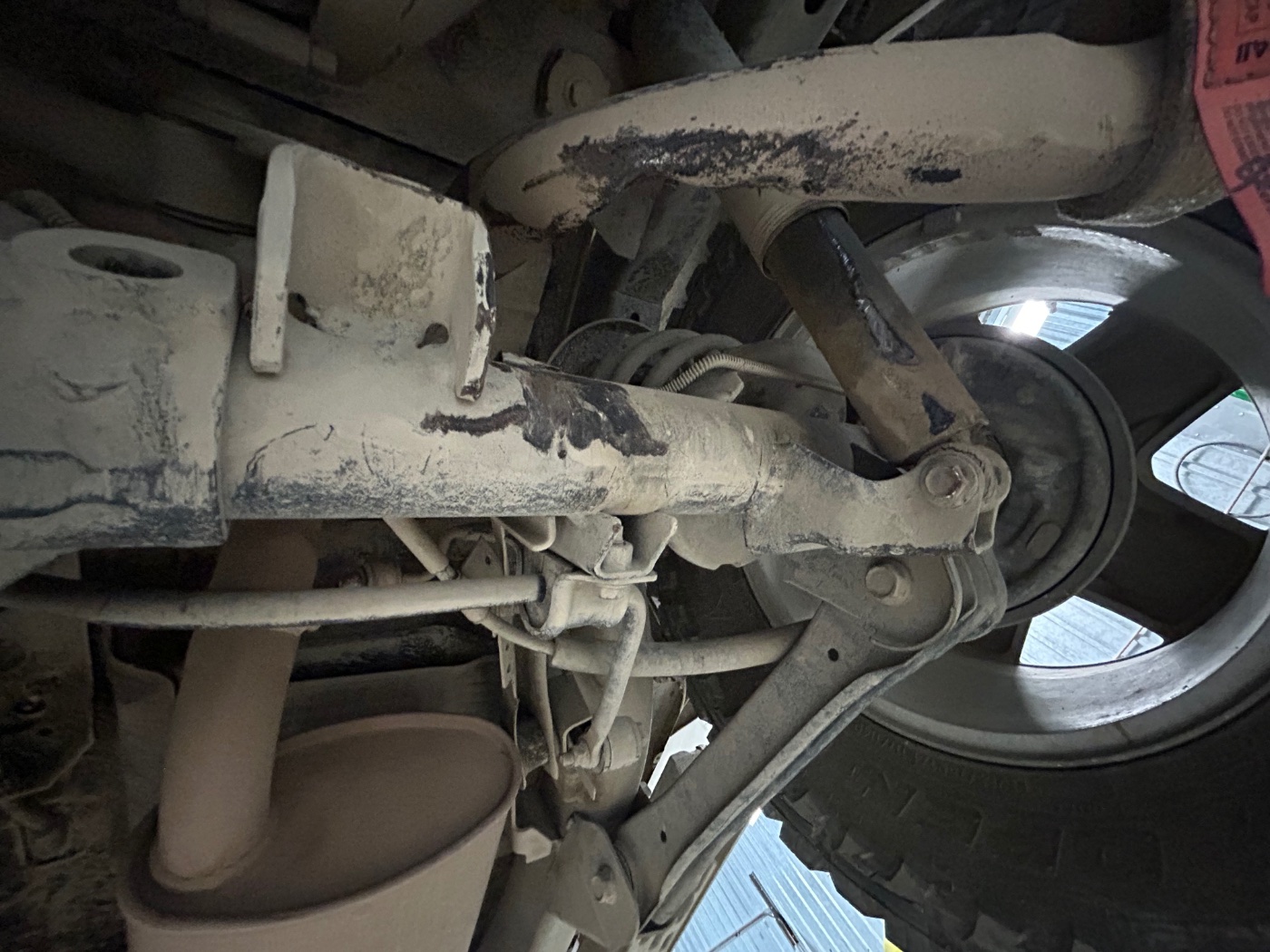

Well got it to work tonight and put it on the hoist. I a bit worried as it was driving real bad. Felt like a loader going down the highway a bit. So I grabbed my tools, and new springs/shocks and bumpstops just in case. Tried cutting the tailpipe back by the muffler but I just couldn’t. Either I cut it just before the hanger and left it unsupported and pointing at the breaker lines, or left the hanger and it pointed straight at the floor. So I cut it after all the kinks, but pointed away from the gas tank and high enough you can’t see how trashed it is. I blew the welds on the muffler Seam and the pipe exit on it. So it all needs replaced.

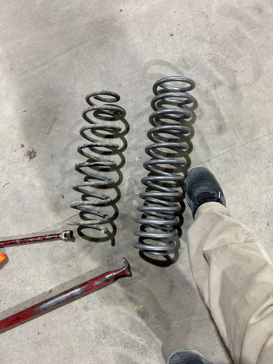

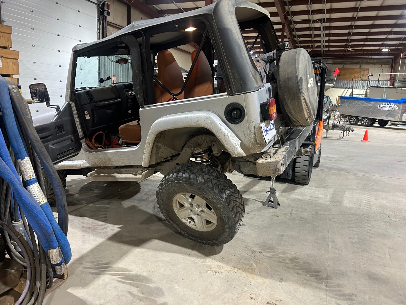

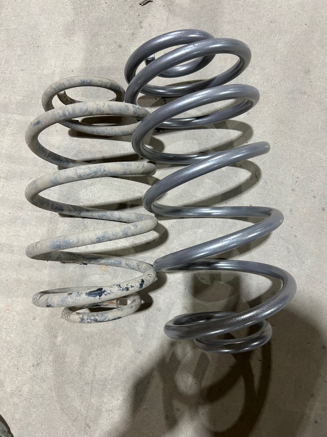

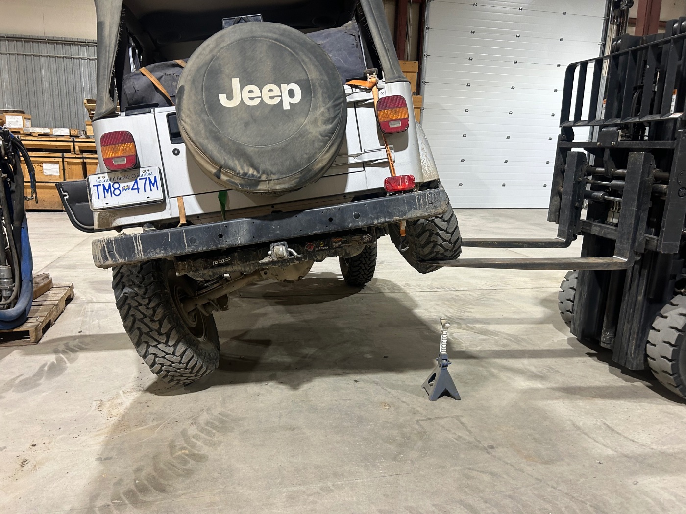

I also noticed the shock had a large amount of damage from the muffler fiasco and it was blown before this happened, and finding nothing else really wrong under the Jeep(connected to the driving issue but we’ll come back to this in a moment) I unbolted the rear shocks(the one with damage was seized up) and sway bar, grabbed the forklift and flexed the Jeep out to pop the springs. Put in the new rough country rears, new rancho rs5000 shocks and bolted the sway bar back up. In the mess of this I also found my trailer wiring smashed and ripped apart. So I cut that back for now, it’s kinda janky and I didn’t have time to mess with it too much, but it’s better now. I’ll need to revisit the wiring in the rear when it’s not full of dried mud and 35 degrees in the shop. Driving home it drives awesome. The rear is a little higher than the front with the 2” spacers. And instead of the rear being moving around, now it’s making the front work. I think these will work good. I just need to get the fronts in. But with quick disconnects and not changing shocks it should be easy.

My wj rc springs did fine.i like the softer rate they use as i keep my stuff fairly light. It was the shocks that were trash. And somewhat the design of things. I don’t care if they say 1/2” or whatever. New is better than 20 year old stock stuff, and they are the spring rate I’m after and long enough to not chase down the trail. Most of the better springs were too short or too stiff. Rock Krawler has an ideal set of springs I think but they are triple the price and 6-8 weeks away, but these I’ve had months before installing so maybe that wasn’t a big factor.

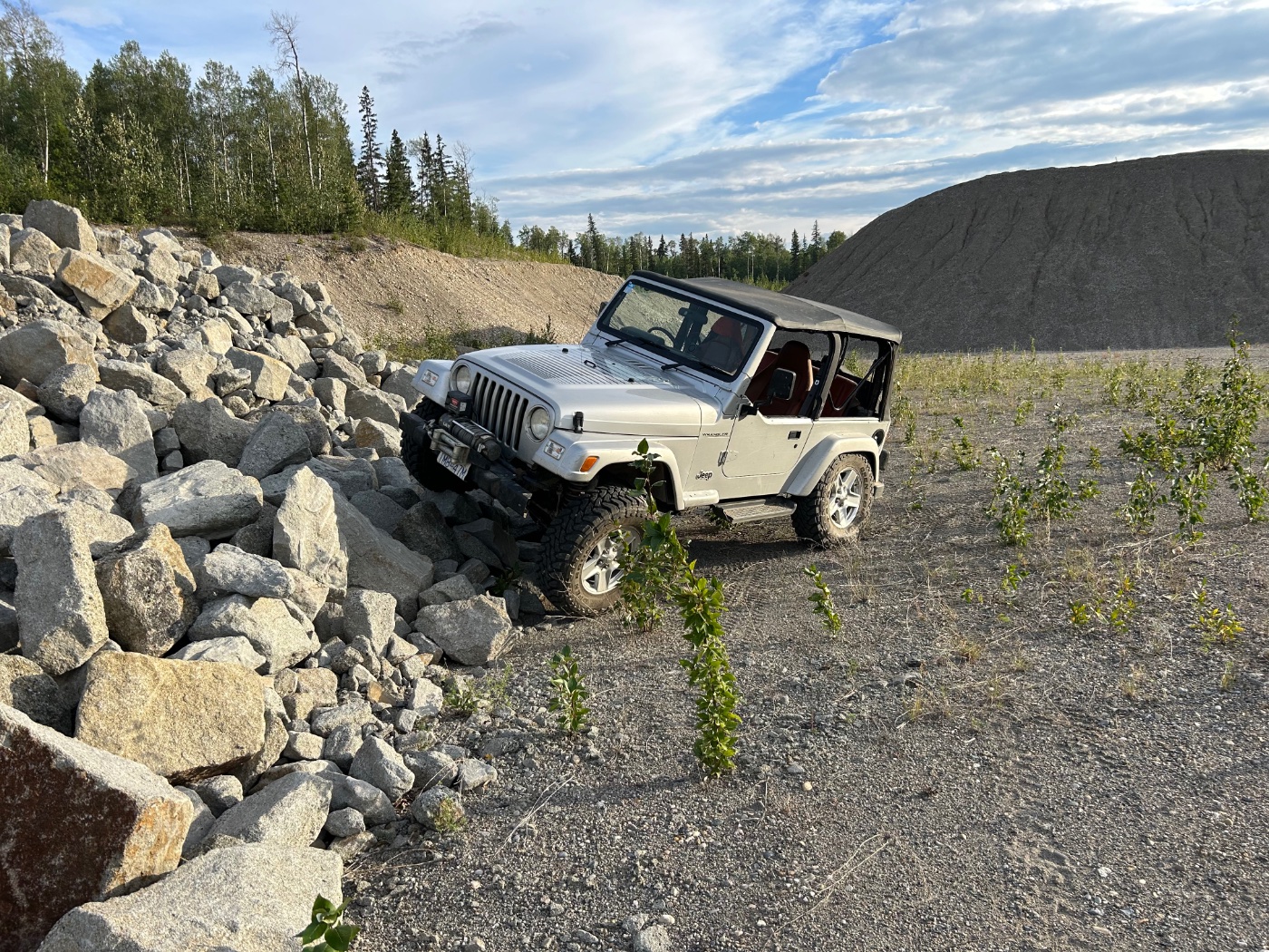

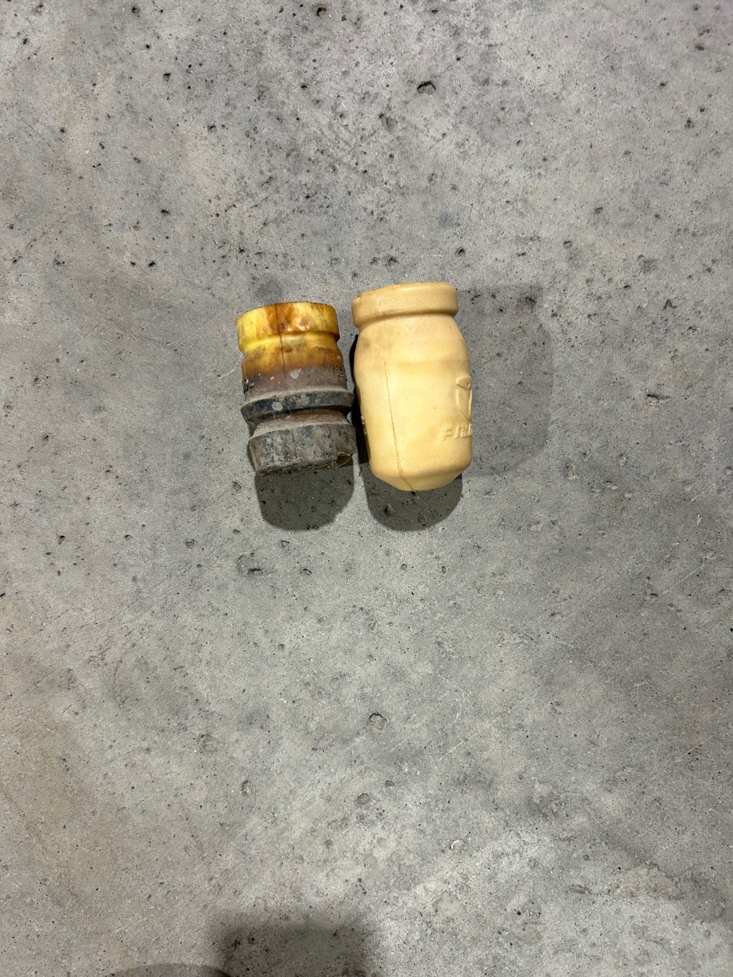

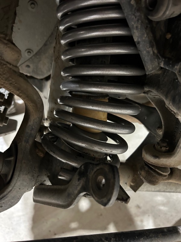

[ attachment=0]IMG_7863.jpeg[/attachment] well went and tackled the front springs. Man it rides really nice now. I had shocks unbolted to get springs in. Only have 1/2” drop left past full shock extension. Got about 32” of flex with out any front tire compression. Fairly decent. I put my front bumpstop spacers in, I forgot to drill and tap the rear. Good thing though as I had to use the longer rear ones up front. The rear is fairly close without them. I might add the shorter rear ones in. One flex pic is with the short bumpstop in and the second is with the longer one on and you can kinda see the extra squish in it. I need longer sway bar and adjustable front track bar and I bracket for the rear. But it drives way better

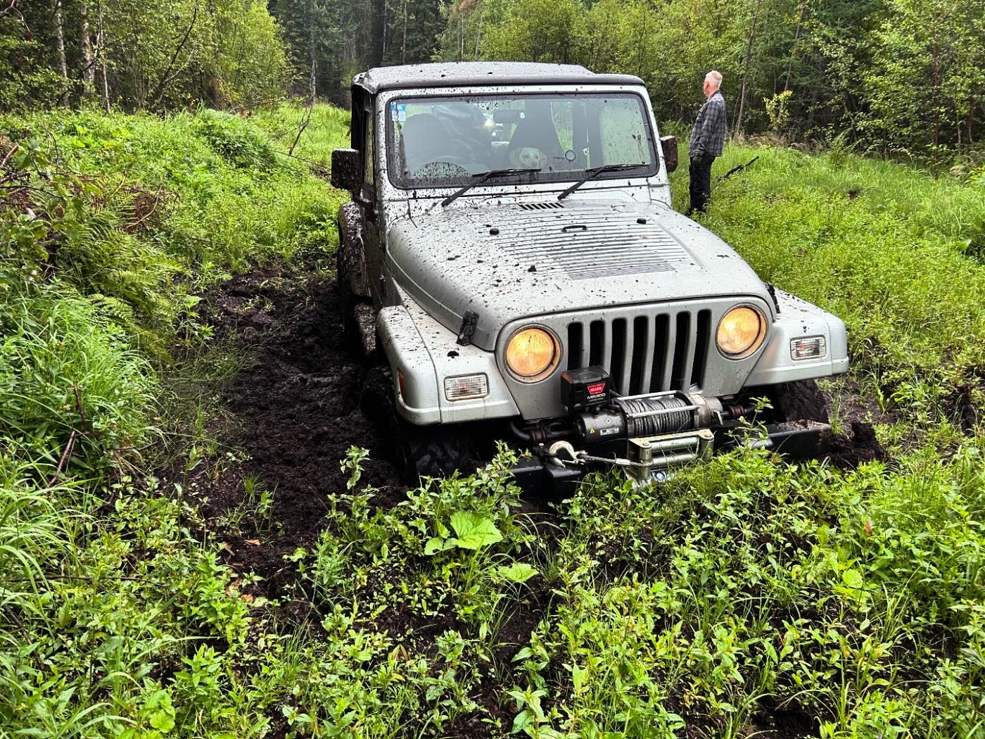

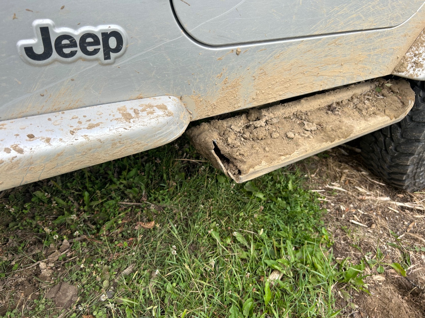

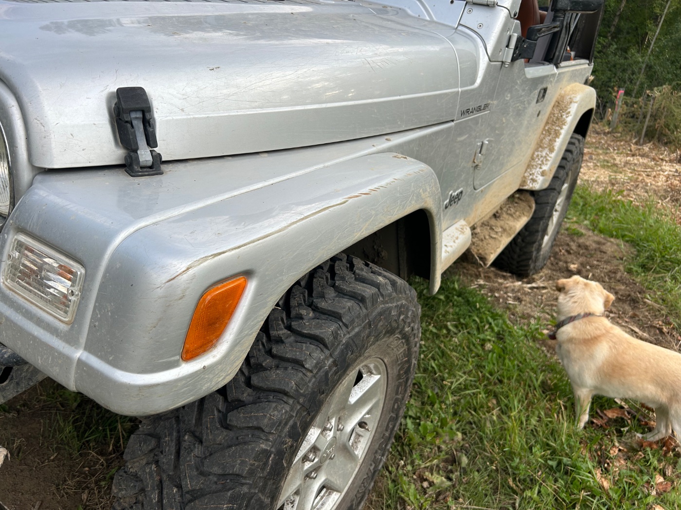

Not much of an update, but I busted a running board, knocked the paint off a couple fenders. And got really stuck. I need my front locker in. It’s weird. It’s flexy and gets around good but once it is pointed up hill and steep the front end kinda unloads and the rear and digs and sinks. It’s kinda hard climbing stuff like I’m used to. Buddies yj with 2 lockers and 31’s does a lot better. Really want a antirock sway bar up front as well. I don’t like it unhooked and it won’t flex hooked up.

Now that my steps are tore up, been looking into sliders, wanted to make my own but I’m lacking time and there’s other stuff I’ll have to make. For the price these seem hard to beat. They mount similar to lots of other ones with similar materials. Any issues you guys see with these smittybilt xrc sliders for the tj

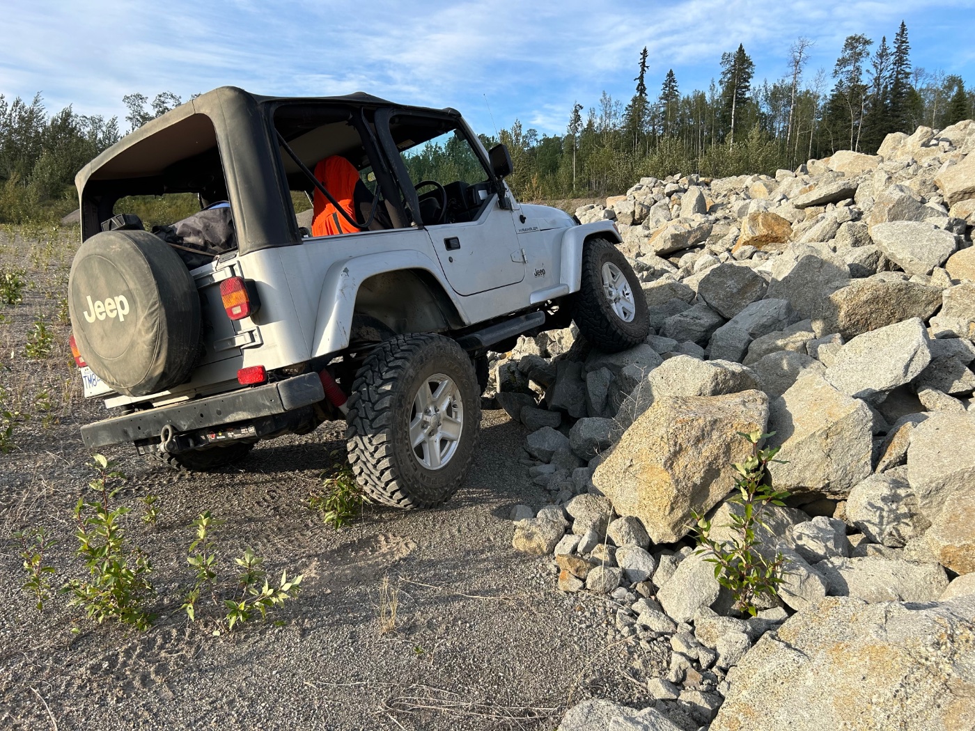

Test run for the locker. Left the sway bar on to make it really work. My daughter ran it through and basketball sized rocks on the beach and she found it harder to steer but I ran some tight stuff and it does really well. It’s pretty seemless and predictable so far. But it’s early on. Definitely helped the rig a lot though.
