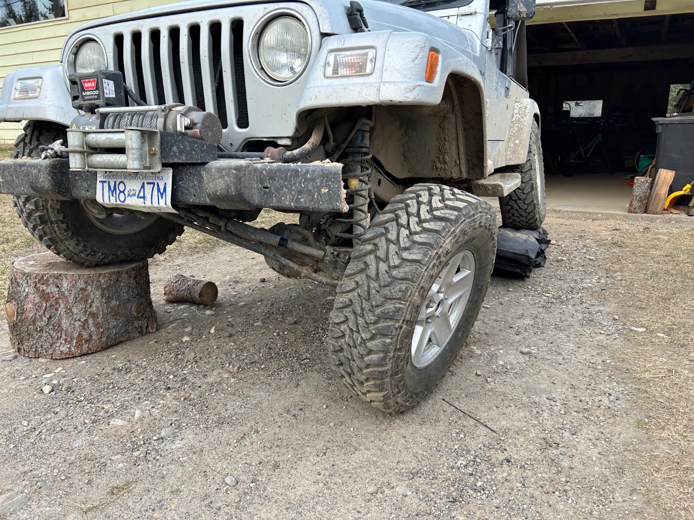

Re: Eris
Post by Scoobienorth »

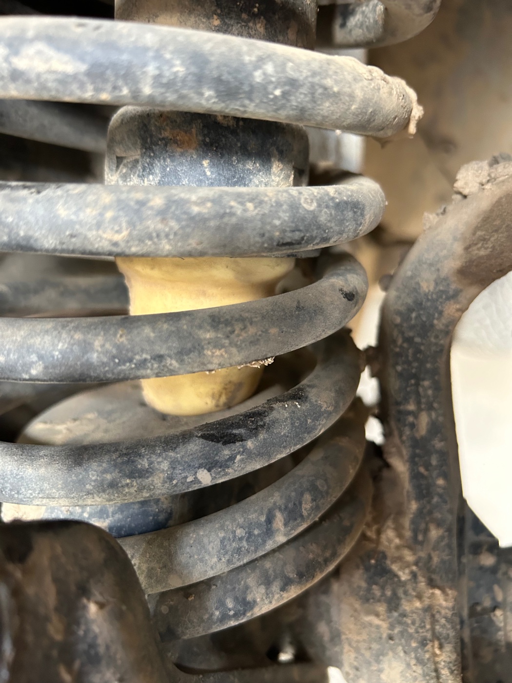

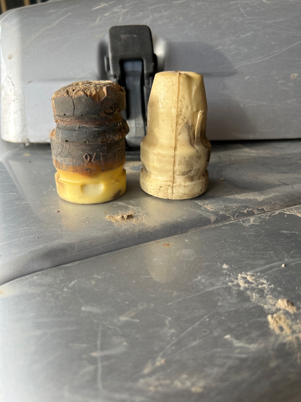

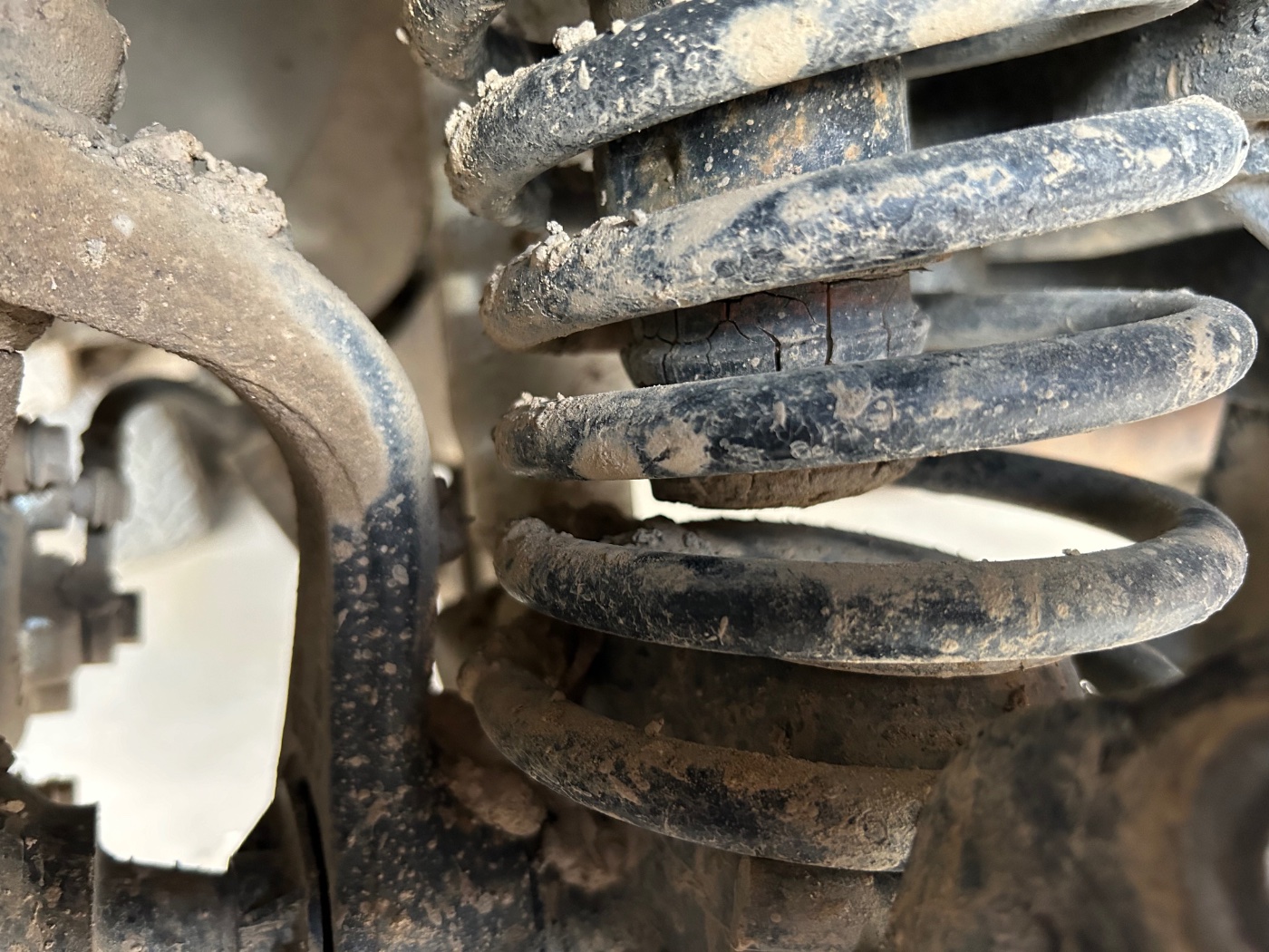

Well been running the Jeep lately and found a few things. Mainly I need my locker and/or need my suspension dialed in. Was scared to disconnect the sway bar because of the long shocks I put in and short springs , even with the spacer taking up room I figured I might lose it. And rear tires rub and the fronts are really close if they didn’t. I went to start putting my front locker in, had about 4 hours tonight of spare time, and I had issues just getting it jacked up and stable so I gave up on the locker install and started messing with the suspension instead. I unbolted the sway bar and flexed it. With the front twisted up I swapped the bumpstops that were falling apart and not reaching the strike pad with my factory gladiator bumps. They just touch but not quite enough to save the shock so I’ll have to change things up

I want to use the terraflex progressive foam bumpstops that I have in my gladiator , the fronts from jl/jt would work all the way around. They are longer and pick up earlier. But I can only find sets with front and rear which means I’d waste 4 rear ones into the trash. I messaged terraflex to see if I can buy just fronts. I need some cushion and a bit more spring rate and up travel in the front. I’m crashing through really easily. I also need springs, for the front I’m looking at 2.5-3” lift and a whopping 21” of free length with a spring rate that’s stiffer than stock but still on the softer side of what’s available. My tires just clear or just rub on the front. It’s literally so close I can’t tell.

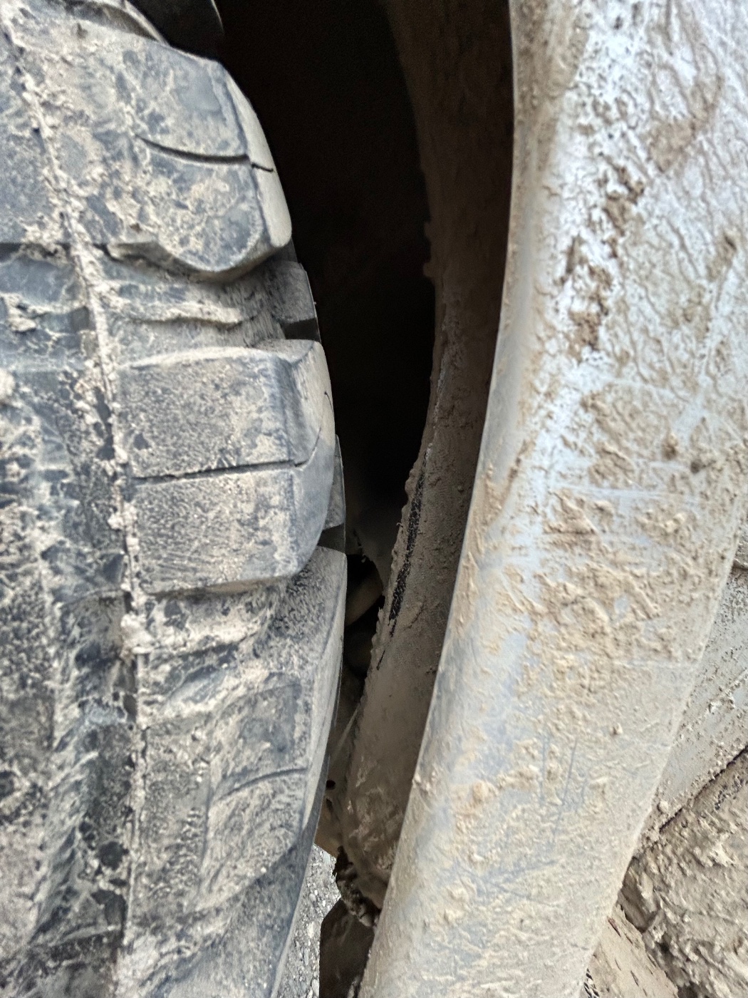

Re: Eris

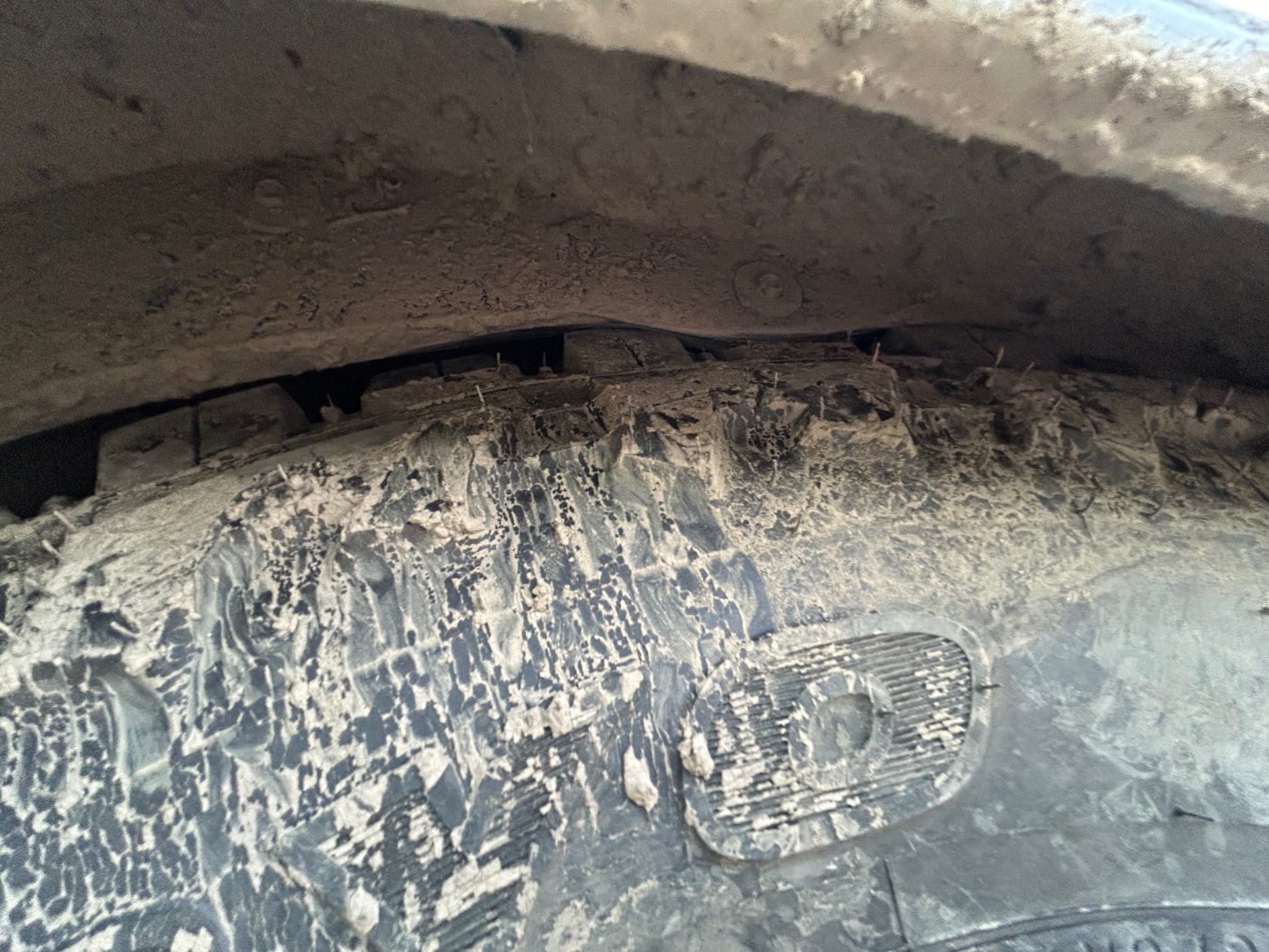

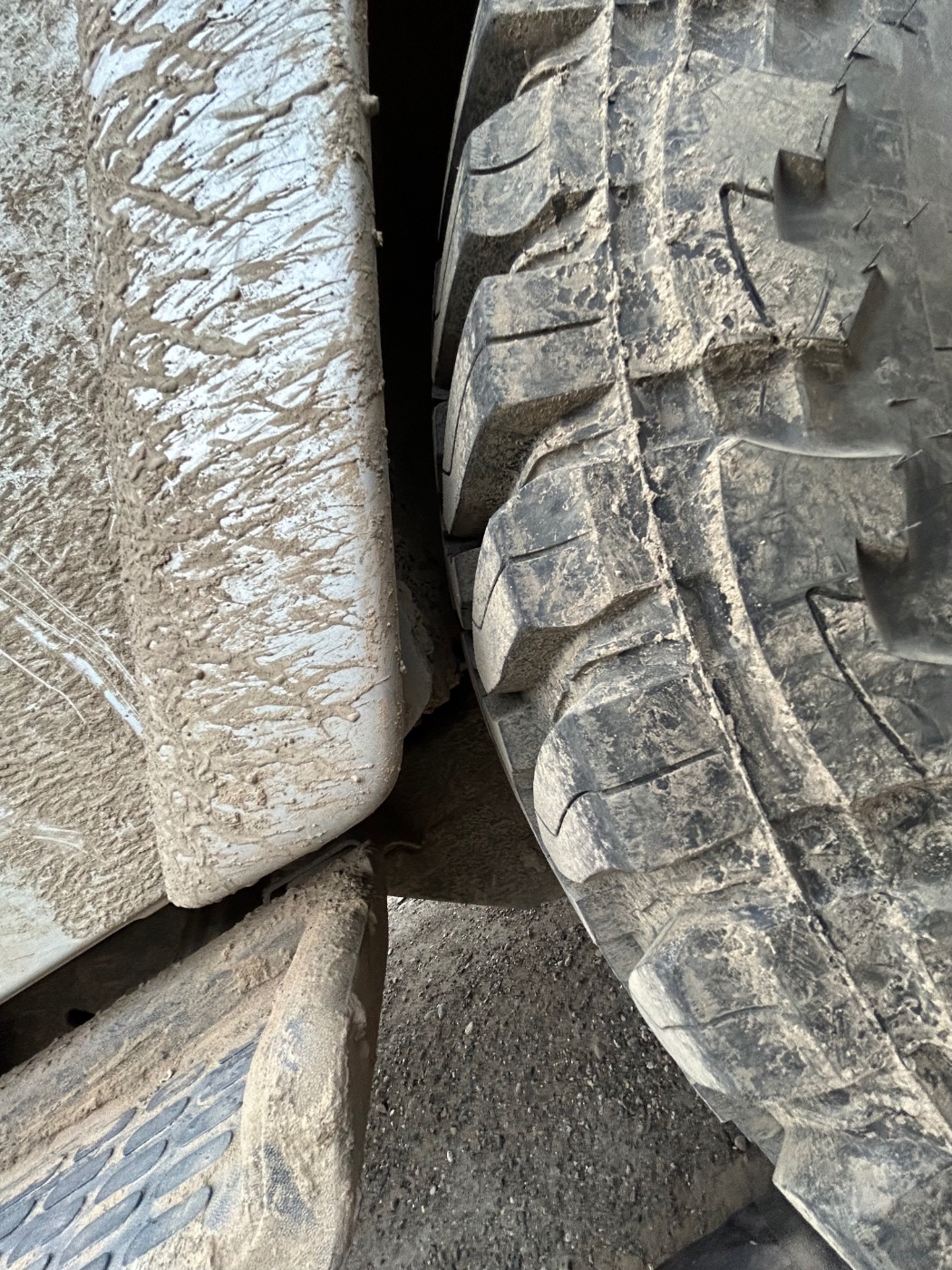

This sketchy flex setup was combined at 28” tall. I had 0.5” drop left up front and I was only using 5” of rear shock. My tires rub in the back on vertical travel before bumpstops kick in but flexing is closer to clearing. I’ve also blown the rear shocks already, the pic shows the tight spots at the front and rear of the wheel well and my failing bumpstop foam no where near the pad either. I’ll find some 1/2” plate steel scrap at work and make some weld on height spacers and hope I can find the front bumpstops for the back as well. I think cleaning up the bumpstop and slightly longer rear shocks and longer front springs I should be able to cleanly lift a tire 34”+ without rubbing.

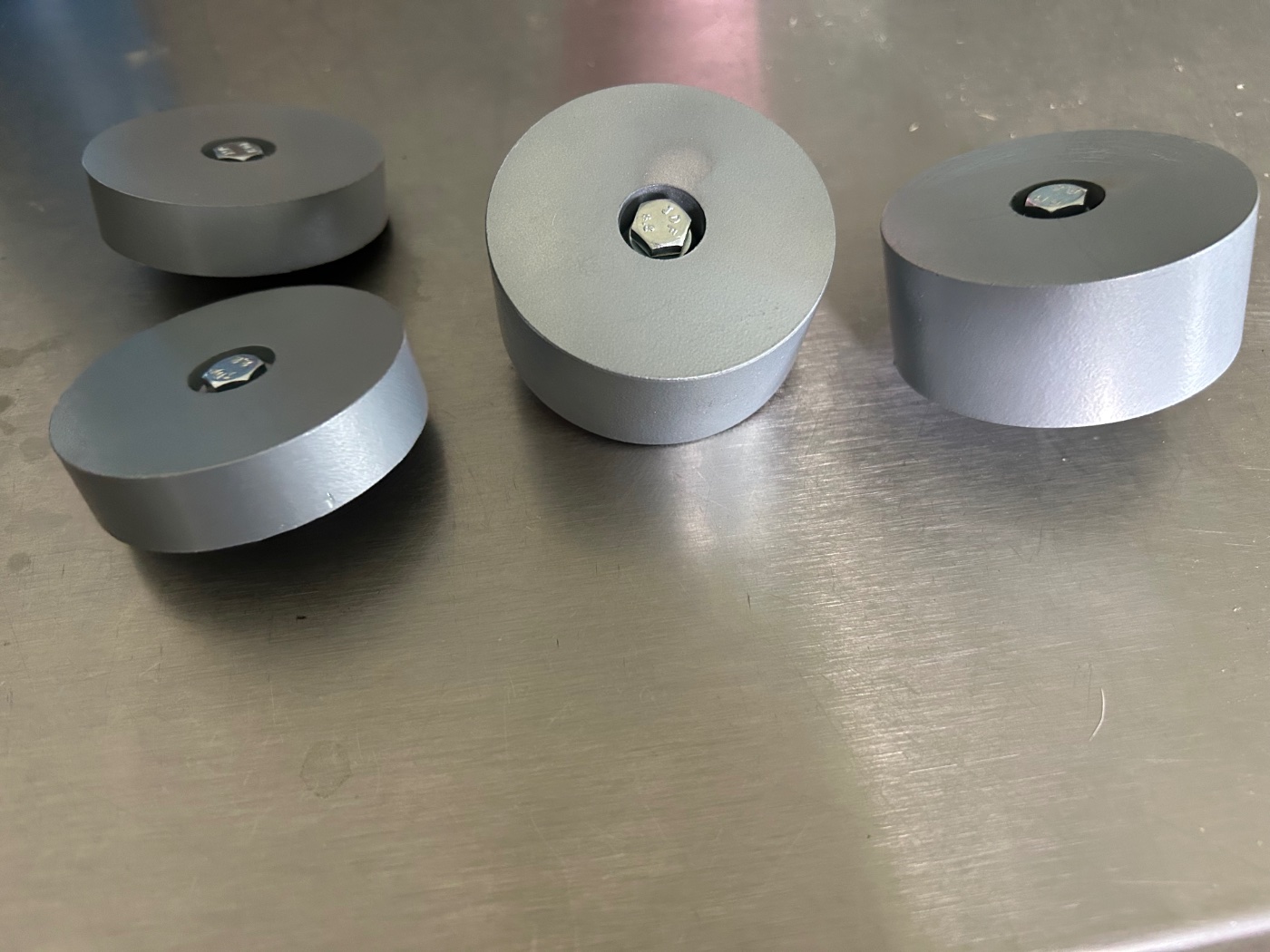

Re: Eris
Not much but trying to do a little when I can. Made some bump stops at work on the lathe and powder coated them. Not sure if it’ll be enough in the rear, but it’ll be closer.

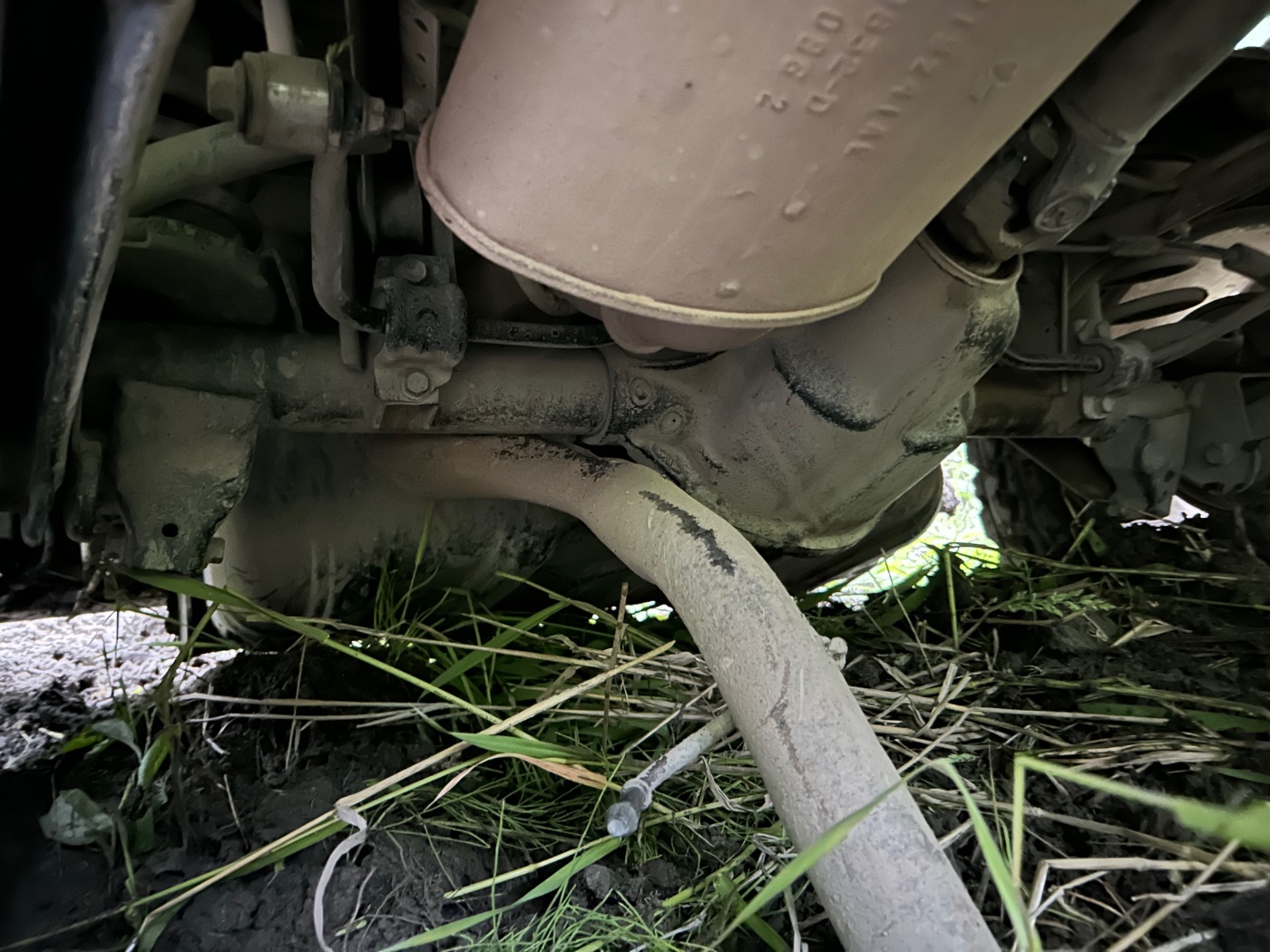

Re: Eris
Instead of working on this. I went and tackled a line no one would , including the sxs and quad guys. Got stuck and long story short I got my exhaust caught in the end of a culvert in a washout backing up and wrapped it around the rear axle. Caused some issues after I winched out. Got caught in the dirt, plugged the muffler up and stalled me out. Buddy had to tow strap my muffler trailer and ratchet strapped it up to get home. And his yj on 31’s drove through where I got stuck. But after I got stuck the line was more apparent.

Re: Eris
Post by Scott Cee AKA 2drx4 »
It's always easier to watch somebody else screw up to find the correct line. Especially if there's any brush involved, first guy will flatten it out and then it's obvious. :lmao:
What are you going to do for an exhaust replacement?

Re: Eris
I’m not sure. Probably take it to work and get it on the hoist and see how much is wrecked. . If it’s good to the muffler probably cut it there for now, it’ll need to be higher clearanced than a stock replacement so it’ll take time for me to organize something
