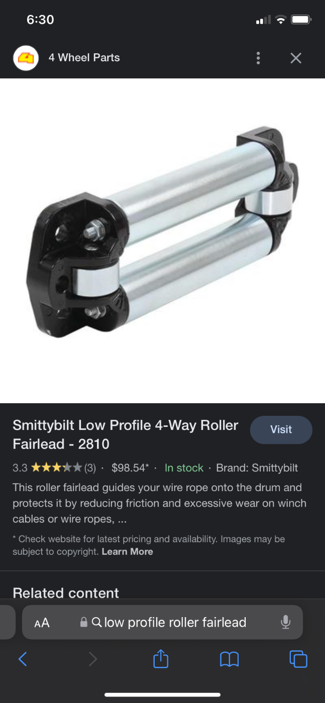

Do you have a decent pic of the low profile roller setup, might be able to build something similar as well

This it?

Scoobienorth wrote: Thu Oct 20, 2022 6:31 am C741E36C-F006-4003-B56F-92B714C15056.png
This it?
Yeah, that's the one. I can get a pic of it mounted if you want. It hardly sticks out though.
