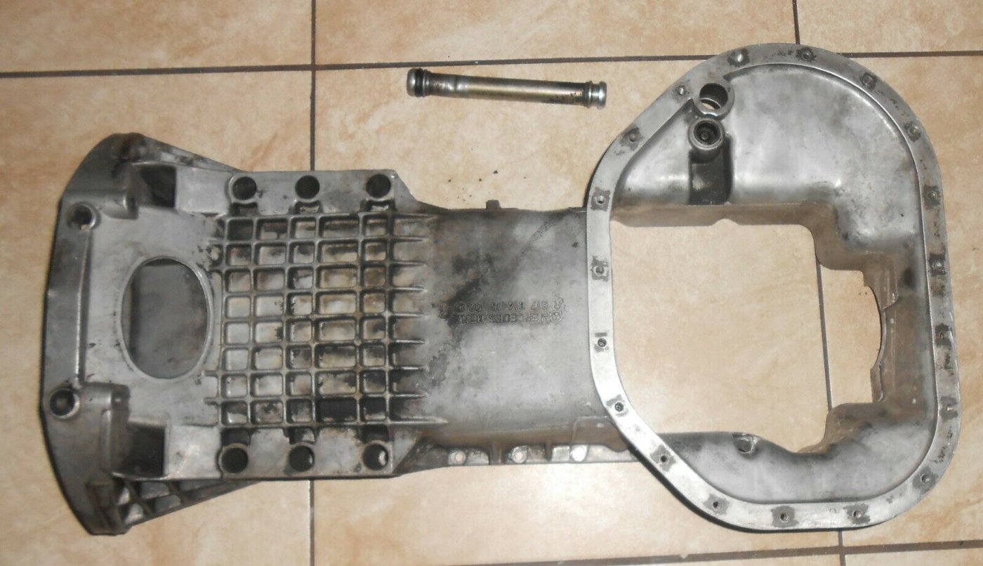

arse_sidewards wrote: Mon Jun 01, 2020 5:06 am Can you post a pic of the pan you're trying to replace?
I'm not really replacing it.
This is the upper oil pan:
The lower pan goes on that flange. That doesn't matter, it's not where I want it and doesn't do anything for me. The plan is to hack most of that flange off, and then mill down the rest of the upper pan so it's go a fairly flat part on it that I can then weld a new flange to for interfacing with a new lower pan. Then I can drill some holes through the upper pan to allow the oil to drain off the windage passages and into the new lower pan/sump. The current setup is front sump, which is going to result in steering and suspension compromises that I do not wish to make. Plus front sump isn't a good idea for anything but a car anyways.
Finding a pan that has a flat flange, is fairly rectangular, and mostly the right shape will prevent me from at least having to fabricate the lower pan. Bonus if it's something cheap like the Ford ones.
