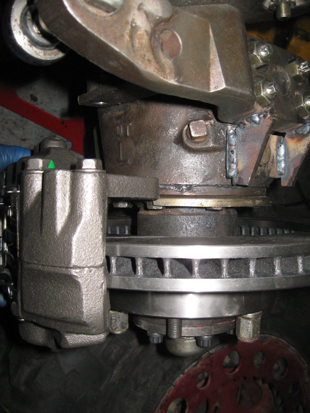

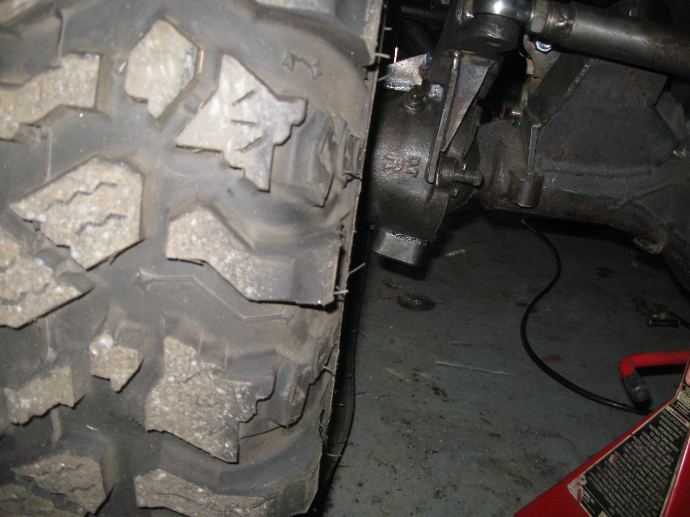

FJ80 is high pinion, flipping the axle to drivers drop would probably be the easiest thing.
most people shy away from the 80 axles because they use an 8" ring instead of the 9.5" used on the 60/40 stuff. but a stock 80 has the width, is high pinion and would meet the things you need to do and be the correct width. pinion drive flange makes it super easy to adapt drivelines and factory elocker is an option
my fj60 axle with minitruck ifs hubs is like a 3 or 4" from centerline with a 37" tire with a neutral/centered wheel. not something i'd recommend for a 31" tire unless you want to run a deep dish factory style wheel. b
here is a rather shitty picture, the IFS hubs add ~1-1/2" compared to the stock hubs
edit: the worst/most expensive part about the fj80 is the price of the high steer arms, you shouldn't need those even if you do different steering and just add to/modify the stock arms
