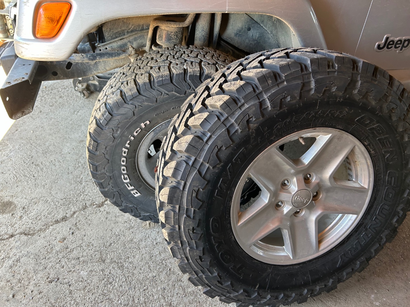

Hilbilt has toyos on the super shopper now and really likes them at low pressures so far

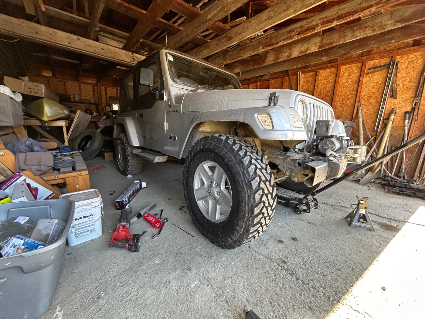

I’m kinda settling in with this. I think I’ll be fairly happy with where this will be at once I add a front locker. I’ll call this my starting point. I didn’t spend any more money than I had to up to now because odds are a lot of it will be getting swapped out as time and funds allow but still be capable enough for what I want to do. Long term plans 1: as a storage compartment that goes on the inside of the rear door that takes up all the room behind the rear seat, but is attached to the rear door. 2: will be tummy tuck with slip yoke eliminator, this might tie into 3: which is stretch the rear wheelbase/fuel tank 3-4” and triangulated rear /3 link up front. At this time I’ll adjust my ride height if I feel it’s too low. For now I just wanted it safe enough to run stock driveshaft. This will be a huge project that I’m not sure if I’ll get to, but I’d like to.

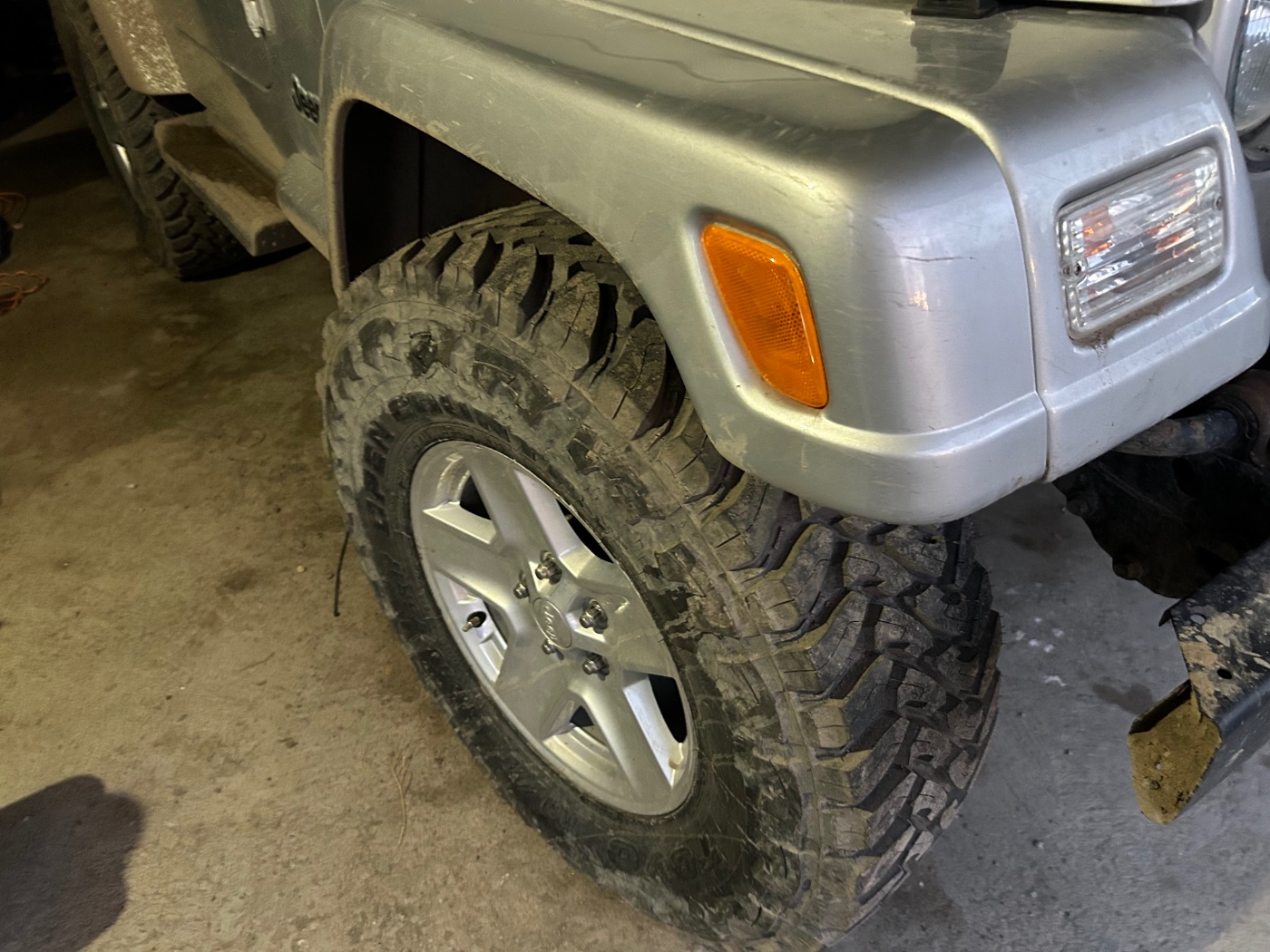

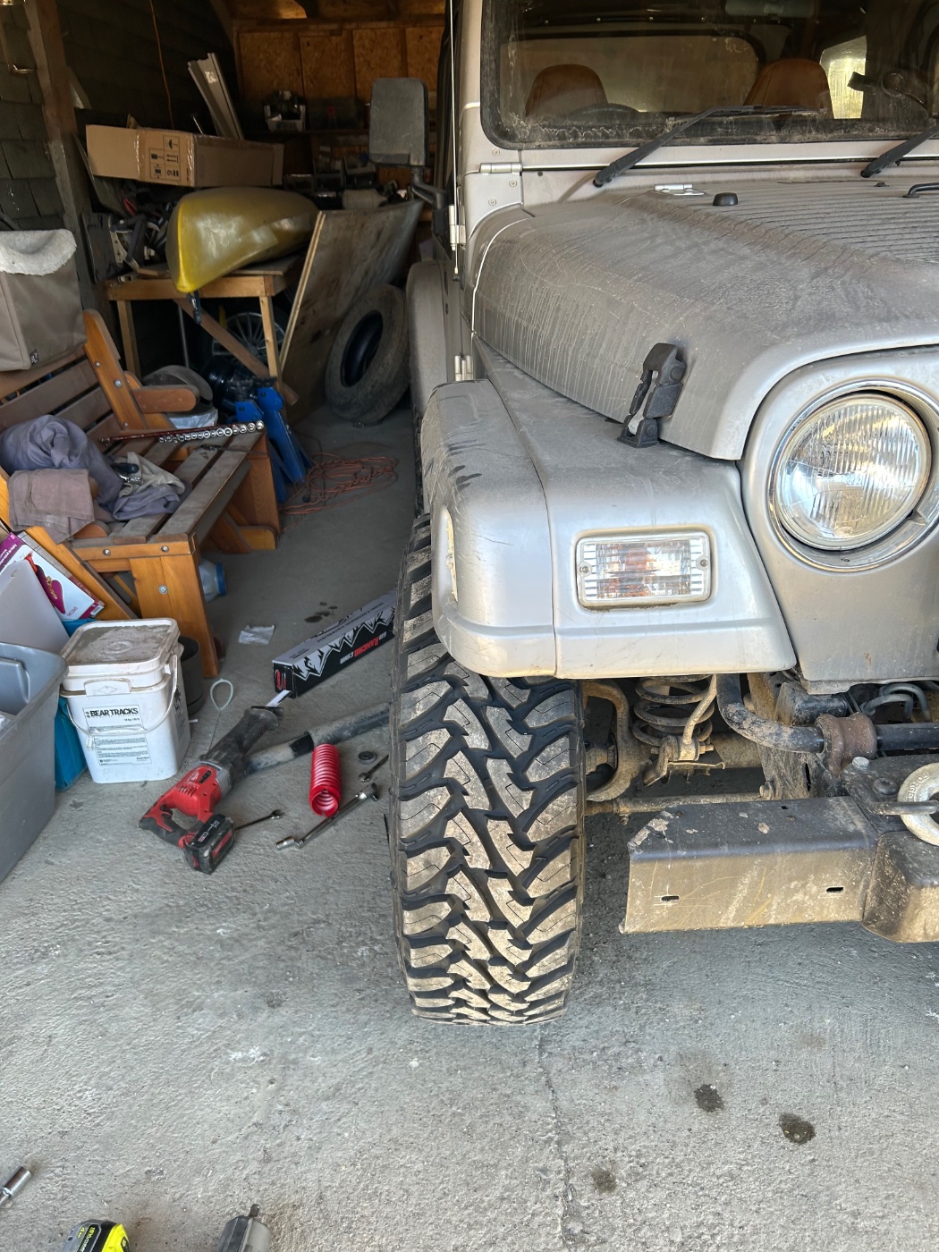

I’m still recovering from shingles in my face and off work still, but I couldn’t take it. This one tire was a ton of work for me to get done, the rear wheel studs are .25” to short. So I did the front and one shock. I had to cut the top stud off unfortunately because it was still really good. I’ll test the bump stop stuff when I retorque the wheel spacers and I’m feeling better. I’m happy with it I think. Mostly under the fenders and a fair chunk taller than the 31’s. Still have room in the fenders.

Quick tape measure, at 15psi so they are squatted they stand 33” tall

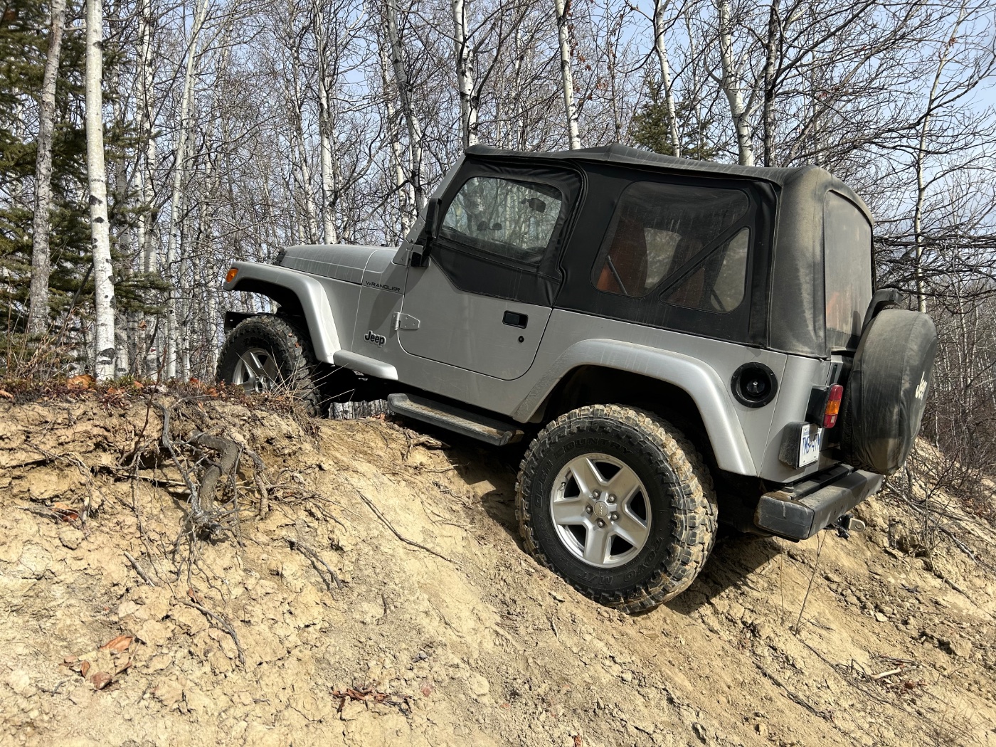

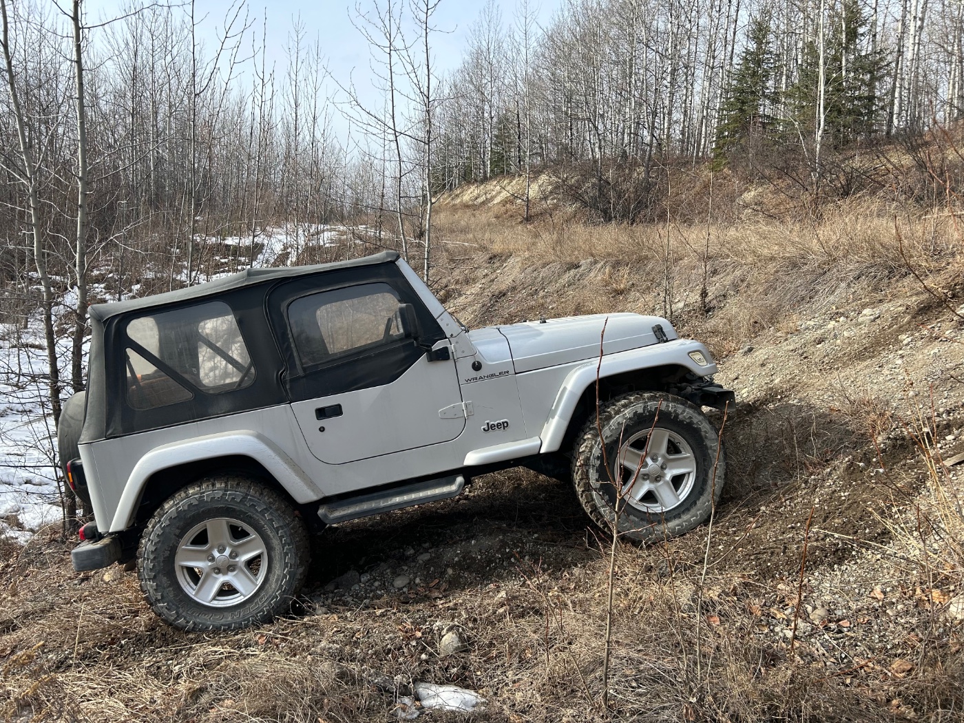

It works pretty good. Still drives fairly stock feeling. Goes further in 2wd than it would in 4wd before. Really needs a front locker. On steep climbs the rear limited slip works really well but it kinda unloads and does the wheel lift up front now. The one climb where I’m bellied out is my nemesis. I’ve bellied out every Jeep on it. And it’s steep. I hammered the red wj on it and almost had it. I’ve only got 15psi in the tires. With the ground partially frozen at 25 psi and a solid bump I might make it. But I’m still chicken in this one. I lifted a tire 2-3 feet in the air earlier in the test run. Thought I was gonna lay it over either backwards or on its side. Being so low it’s really stable.

Actually got out for a short ride. Didn’t take any pics. But the tires work good. I have to adjust bumpstops. I rub pretty hard in the rear, and gently rub up front. I need to make some spring retainers for the fronts anyways, otherwise I’ll have a Jeep full of kids as I’m chasing a spring down the trail.
