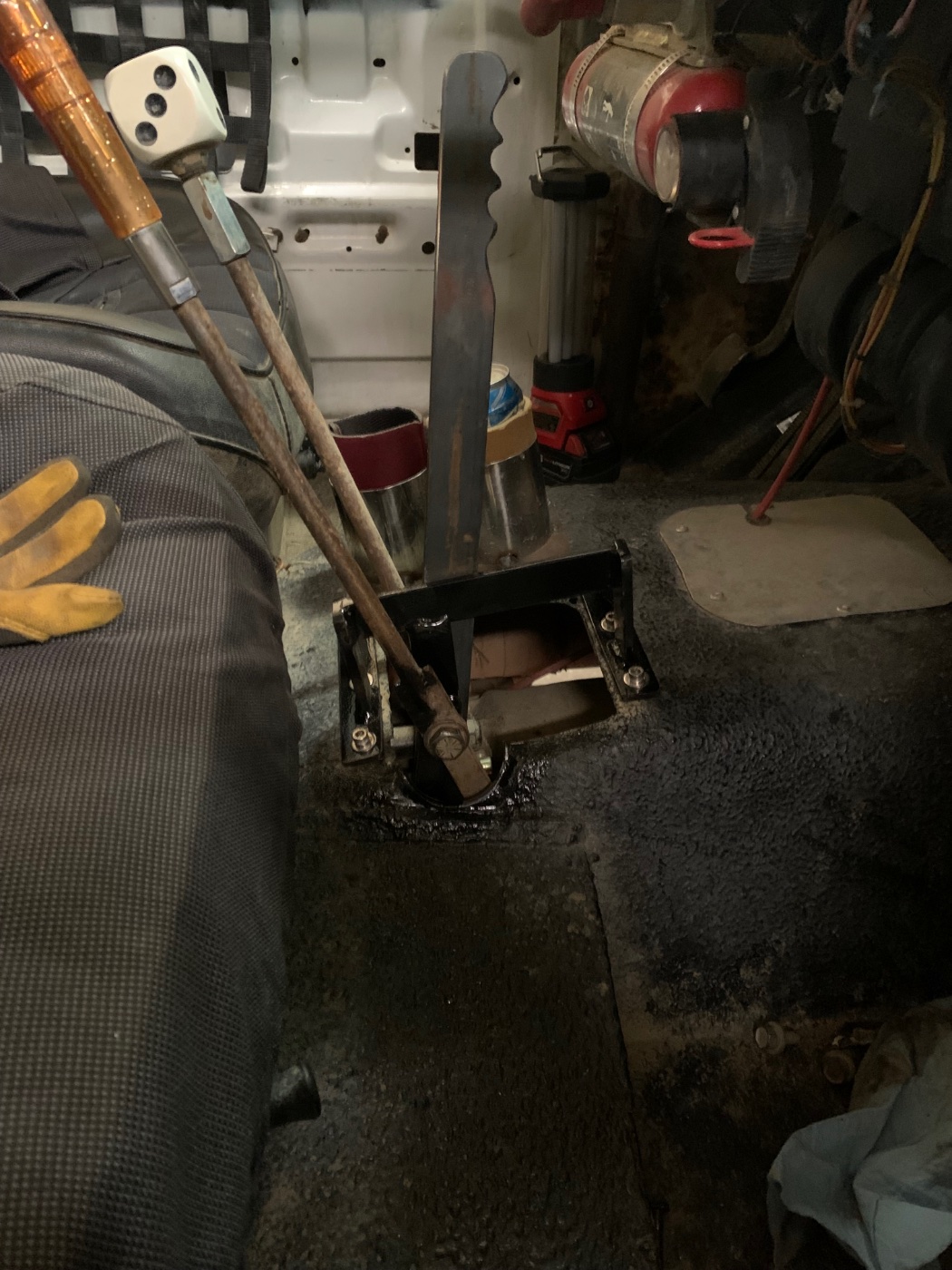

I then tried to make a MFer range stck that would hold my tcase in 3:1 with a bolt and pin so I could utilize 5:1. It didnt end up working so I have since removed the linkage and have my rail bolted back into 3:1. Oh well, I will start the hunt for a 205 and then pony up for an underdrive unit in time.

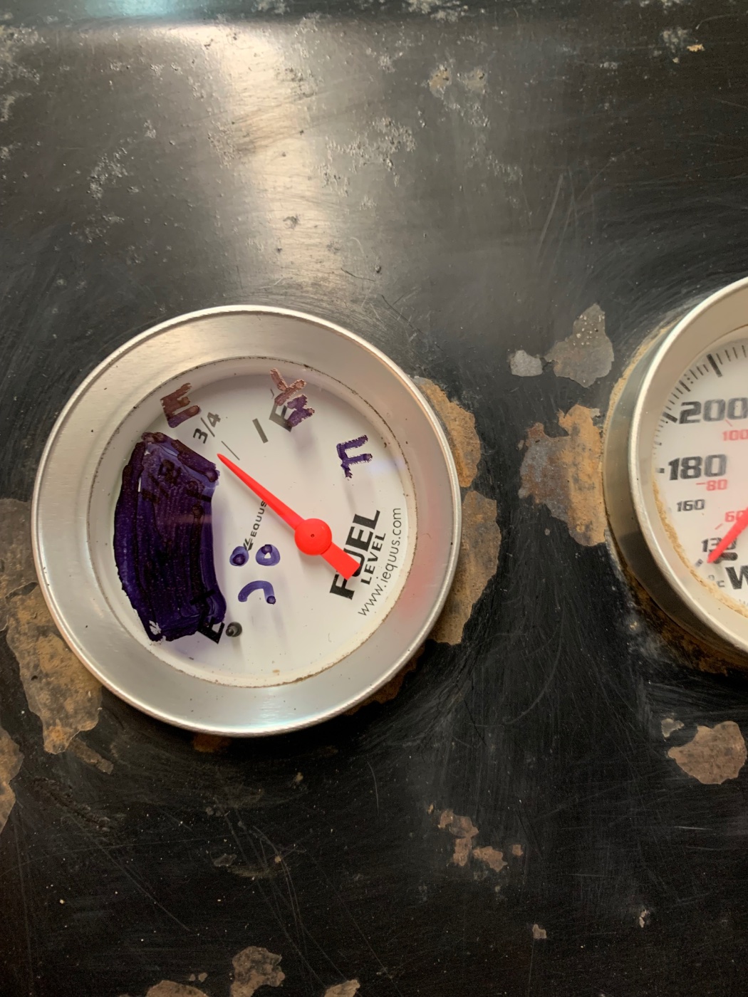

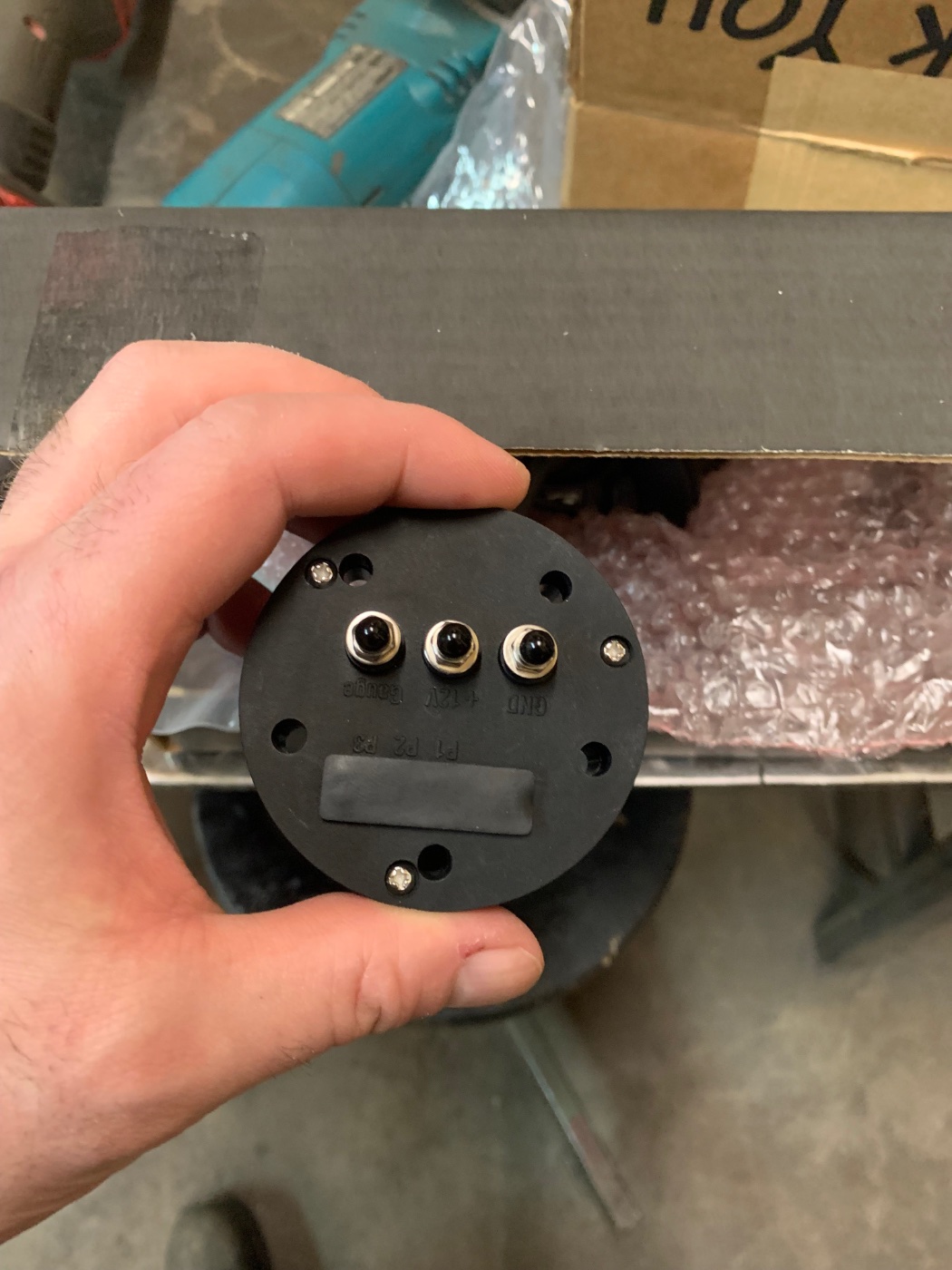

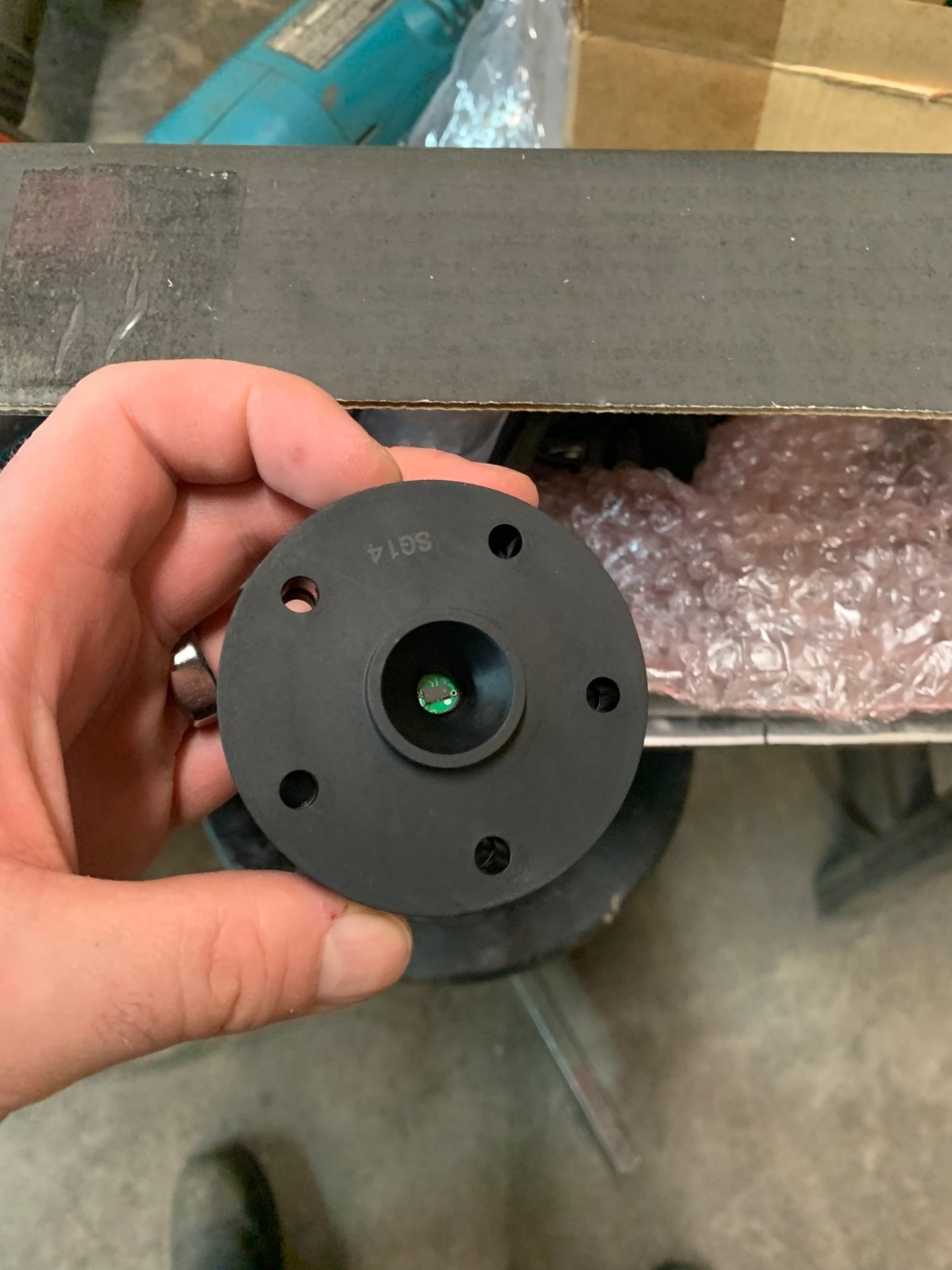

Erarlier in the thread I had mentioned I had no way to check fuel level. So gave this Holley laser level gizmo a try. I dont have an pics of install but pretty strait forward and easy to use. Can be used on any tank or any gauge. Pretty slick.
I had this old gauge laying on the shelf and its was junk. I could only get it to sweet partially, so I modded it up

That Holley fuel level thinger looks cool. Do you just calibrate it for empty and full, and then it spits out a reading for everything between? Edit, it looks like it's meant for use with PWM gauges, which might be why it didn't work so well with that Autometer gauge. That's a bit of a WTF, but par for the course with a lot of the newer Holley stuff.

The fuel gauge is exactly what you said for setup. You can set it up on a bench you just need to calibrate the distance from full to empty and then hook it up to the gauge and set those to the sweep set points. It’s pretty cool, I think so anyway lol.
