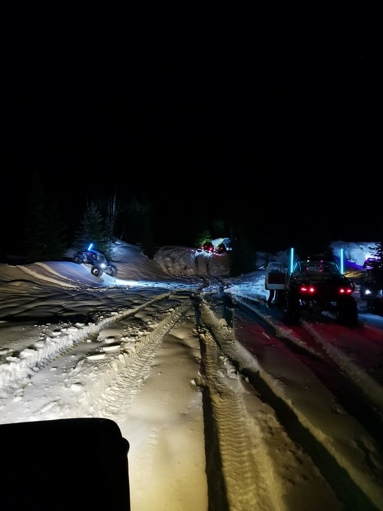

Re: ADHD build
if you got off the hard pack tracks it was sugar snow but could work it and usually could back up enough to get back on the hard pack. so could have been better but was way better then the snow few weeks ago when we tried bottom of baldy

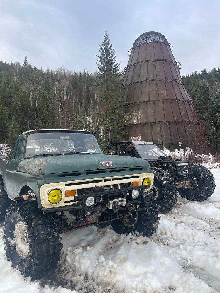

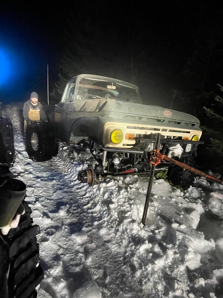

Re: ADHD build
buddy got a good action pic from right at the end of the day on the last trip out

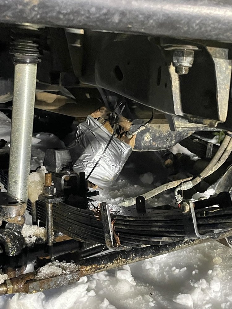

been working on few small things on the truck
rear tail lights, instead of trying to find new lens i just cut the box for some flush led lights. used a micro switch on the pedal to turn them on
added some braces to the trans crossmember as feel like the frame was flexing. used the stock upper bracket and cut it and added a tube to the new trans member. ugly but hopefully works
made a muff pot so can have some warm trial snacks

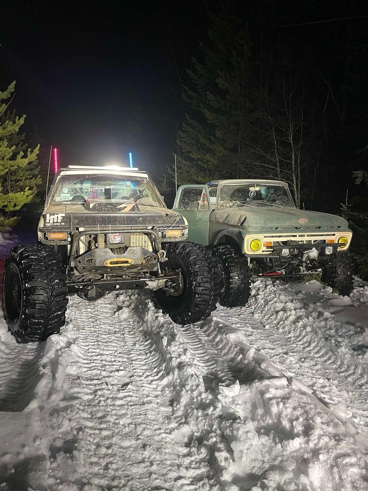

Re: ADHD build
almost trouble free, ignition coil shit the bed near the end of the night but i pack a spare so easy swap. Steering ram needs a seal kit as its bypassing a bit so can feel it but thats cheap and easy fix
