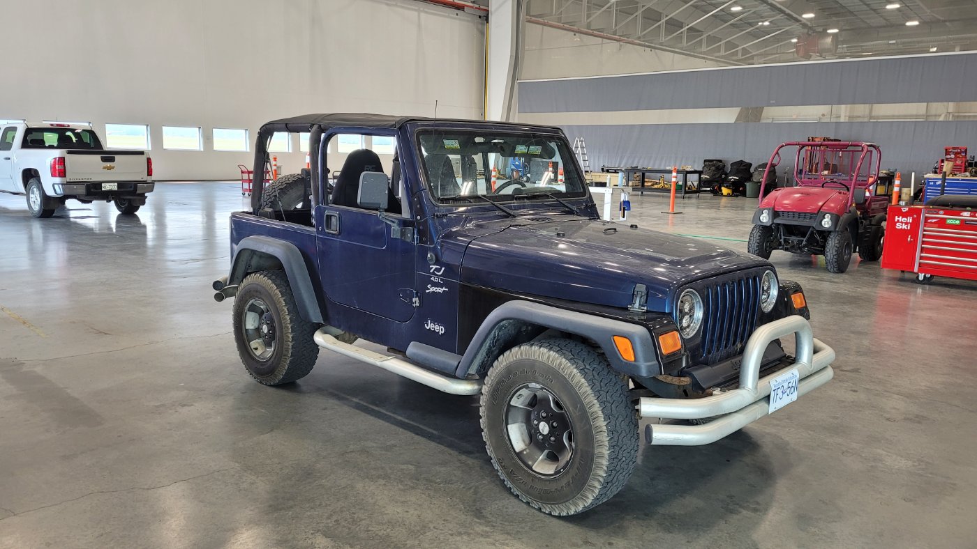

I decided I enjoy this thing enough to throw some parts at it.
I ordered the (likely terrible) Rough Country RC66330 4" long arm kit.
I haven't ordered anything else yet. I will need a SYE, or to put a JK tcase in it (I have one, not sure it's a good idea). And I'll need a new rear driveshaft. And I need a rear axle that isn't a D35 (going to talk to the wrecker on Tuesday may). And some wheels and tires. I think just some 15" steelies and some 33"xwhatevers. It seems like 34" stuff for 15s isn't common anymore? I'll have to look into it more. I don't really want to go to 17" wheels, or use adapters, or put JK/JL takeoffs on it this time.
