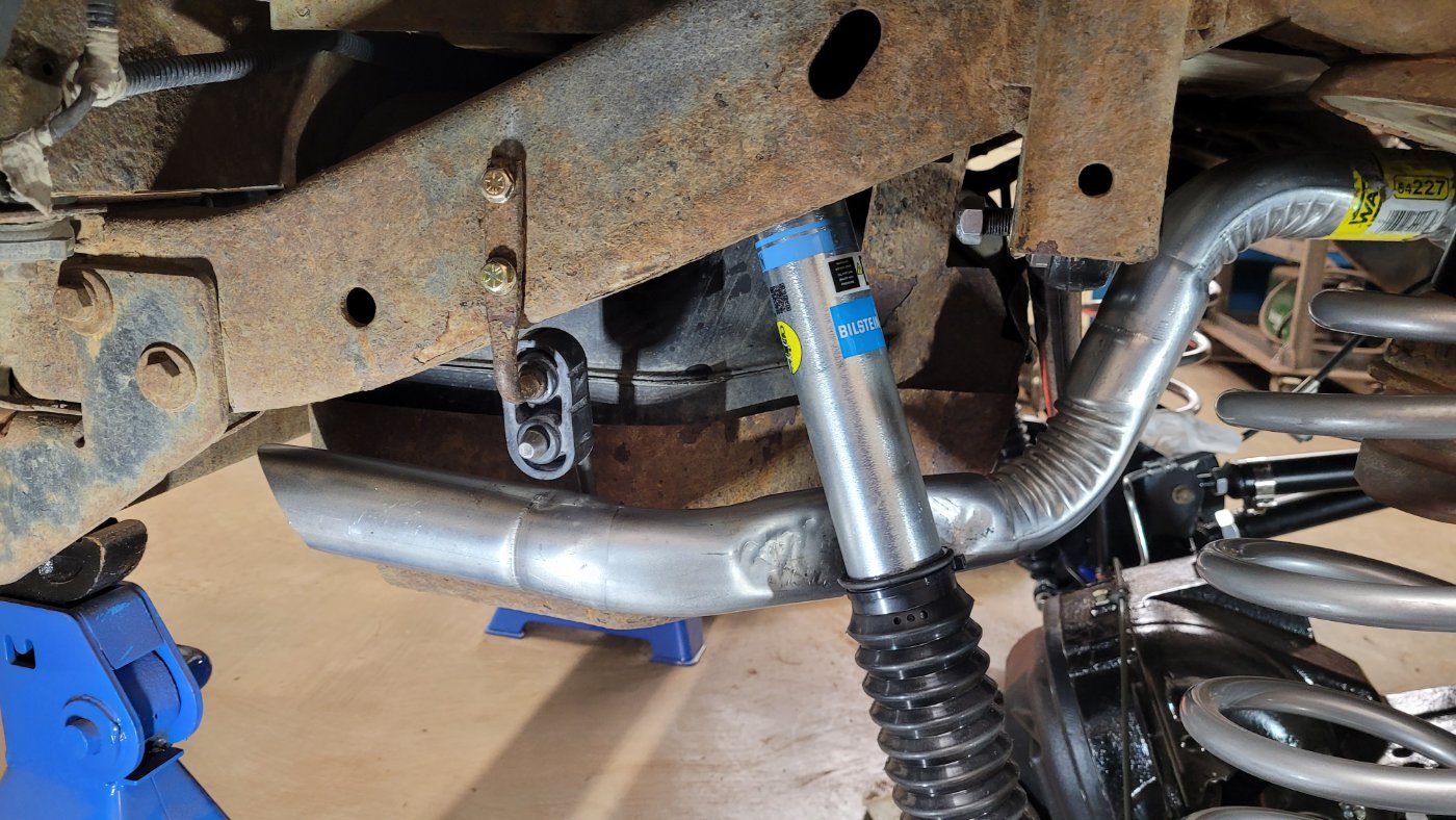

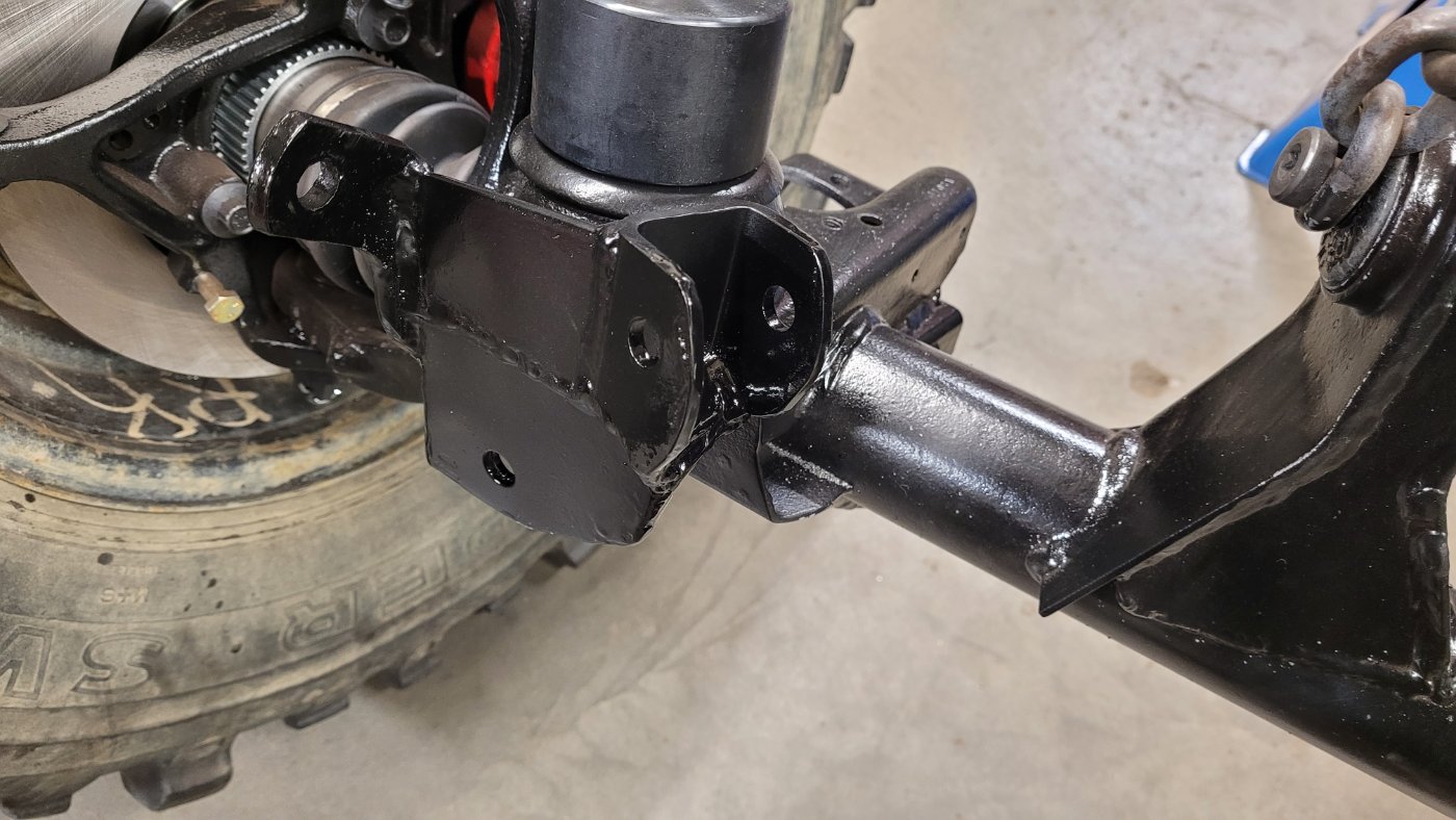

The shock hit the exhaust so I "fixed it": Just random pics of this trash: The extended brake hose was long enough by itself: I'm going to try to work out a clamp for that brake hose so it clamps to the upper control arm.
I still didn't get weight on the wheels, so adjustments aren't certain. I need to throw the ebrake cables in there too and see what sort of clamping I might need to do on them. Also, I installed the lower control arms backwards, but that was intentional. I'm not really a fan of how they wanted you to do it. The RC stuff is certainly not a great design, but it's what I paid for.
I should have know better, it wasn't going in nice. Anyway, I drilled it out and put a longer bolt right through with a nut on it, since it was an outer bolt and you can access the back side easily enough.The shock hit the exhaust so I "fixed it": Just random pics of this trash: The extended brake hose was long enough by itself: I'm going to try to work out a clamp for that brake hose so it clamps to the upper control arm.

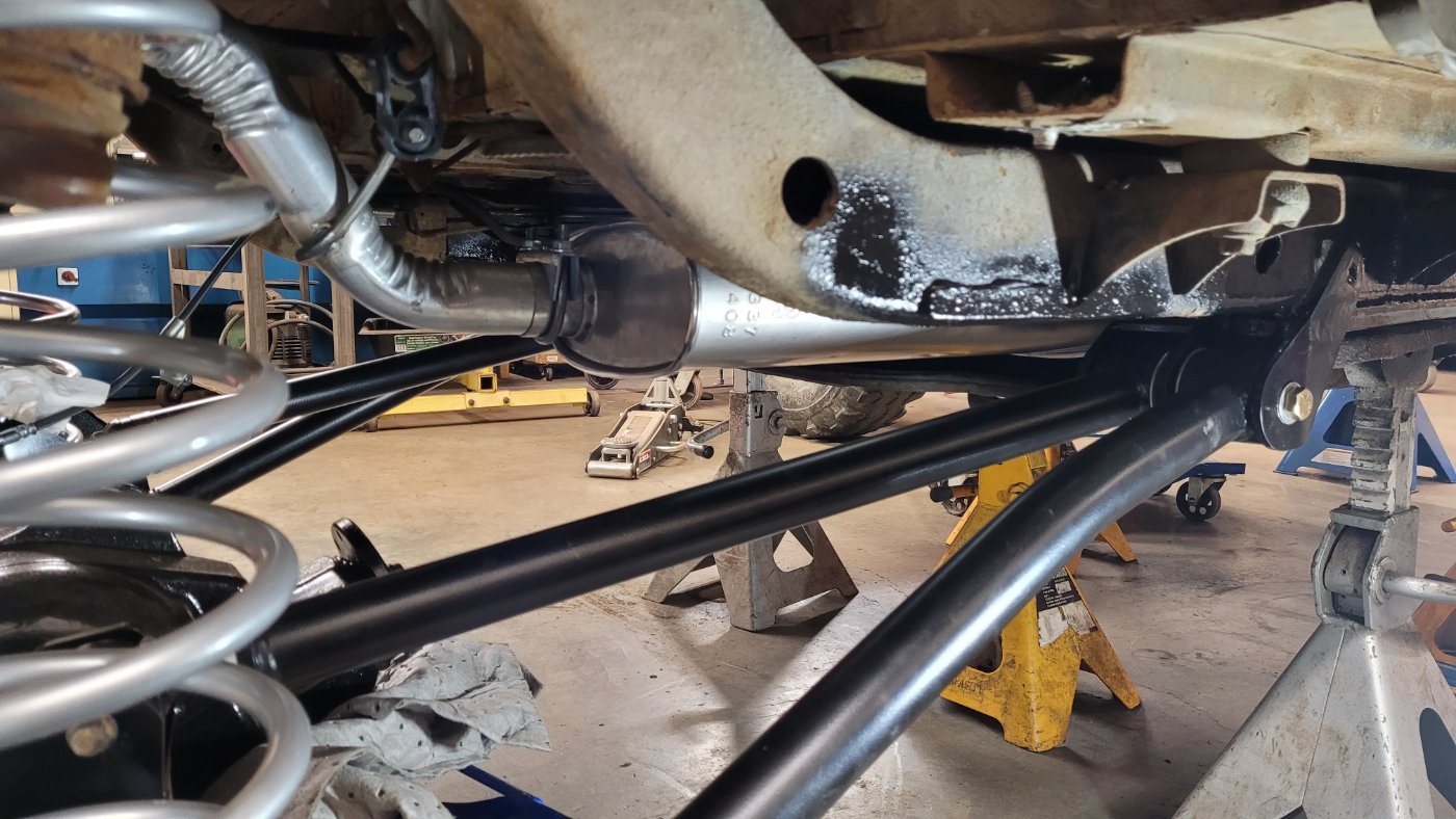

I managed to clamp the ZJ ebrake cables and the brake hose decently-ish.
The bandit clamps were a bit big, so I put some rubber in with them, they'll probably work okay or not. I could buy some that are a bit smaller if it doesn't.
I might try to tweak the ebrake cable brackets a bit more to see if I can get them to be less kinky. Or I'll switch to a different style of clamp on them. Or I'll leave it.
