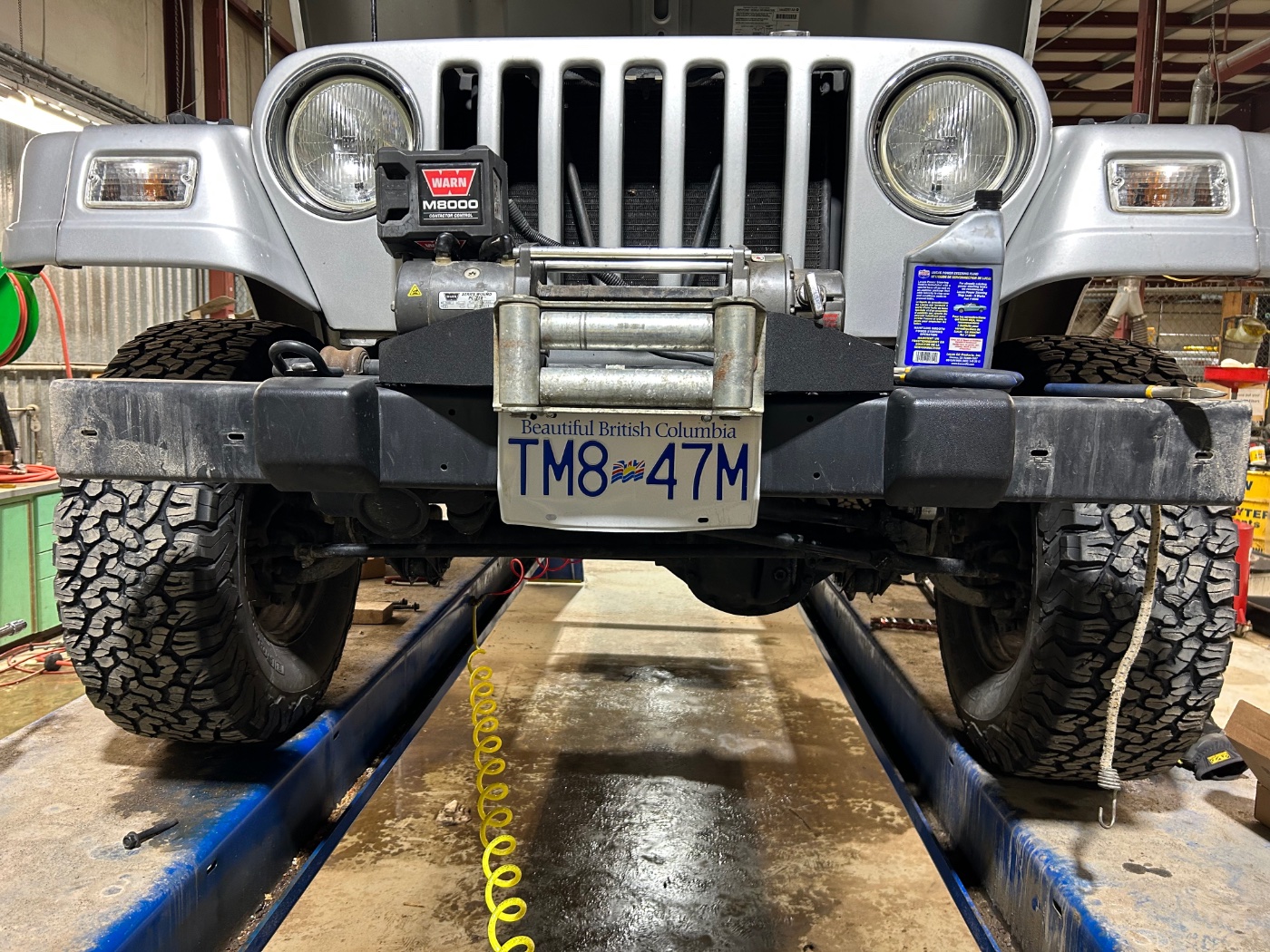

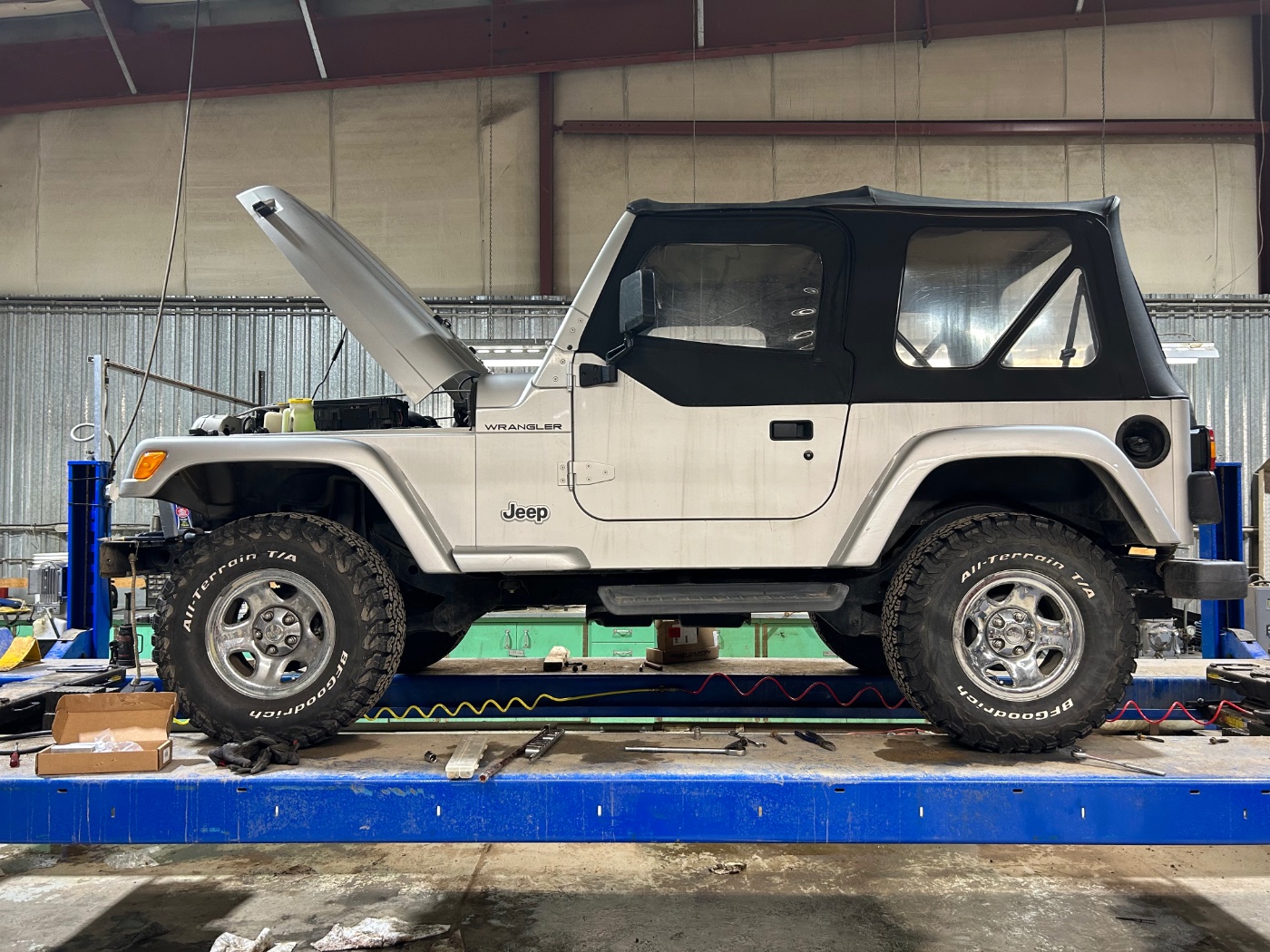

Couple better pics of the winch mount, got the 1.25” body lift installed today, tomorrow I need to go back and do the motor mount lift , and locktite/torque the body bolts. I also found my low pressure side of my power steering leaking so I fixed that, wired the winch up. Tomorrow I need to also tie up the wiring for the winch and spool the cable on. Then it’s ready for tires. It still needs some maintenance done. Slowly getting rid of the old oils and stuff

Back into the wild, all done. Motor mount lift was a bit of a pain due to the ac compressor being in the way for the bolt on the motor mount to come out. So I had to take the whole bracket off the engine, which was hard due to the cats, o2 sensor, driveshaft and upper control arms being in the way. Very thankful for the hoist though. I forgot how good drum brakes are for parking brakes. Pulled my park brake on and started spooling my winch in, after about 2 layers it was really pulling tight, so I looked behind to notice that I had been locked up on the rear tires, ash’s had run out of water for lube, but it’s all working I think. Really needs some tires next.

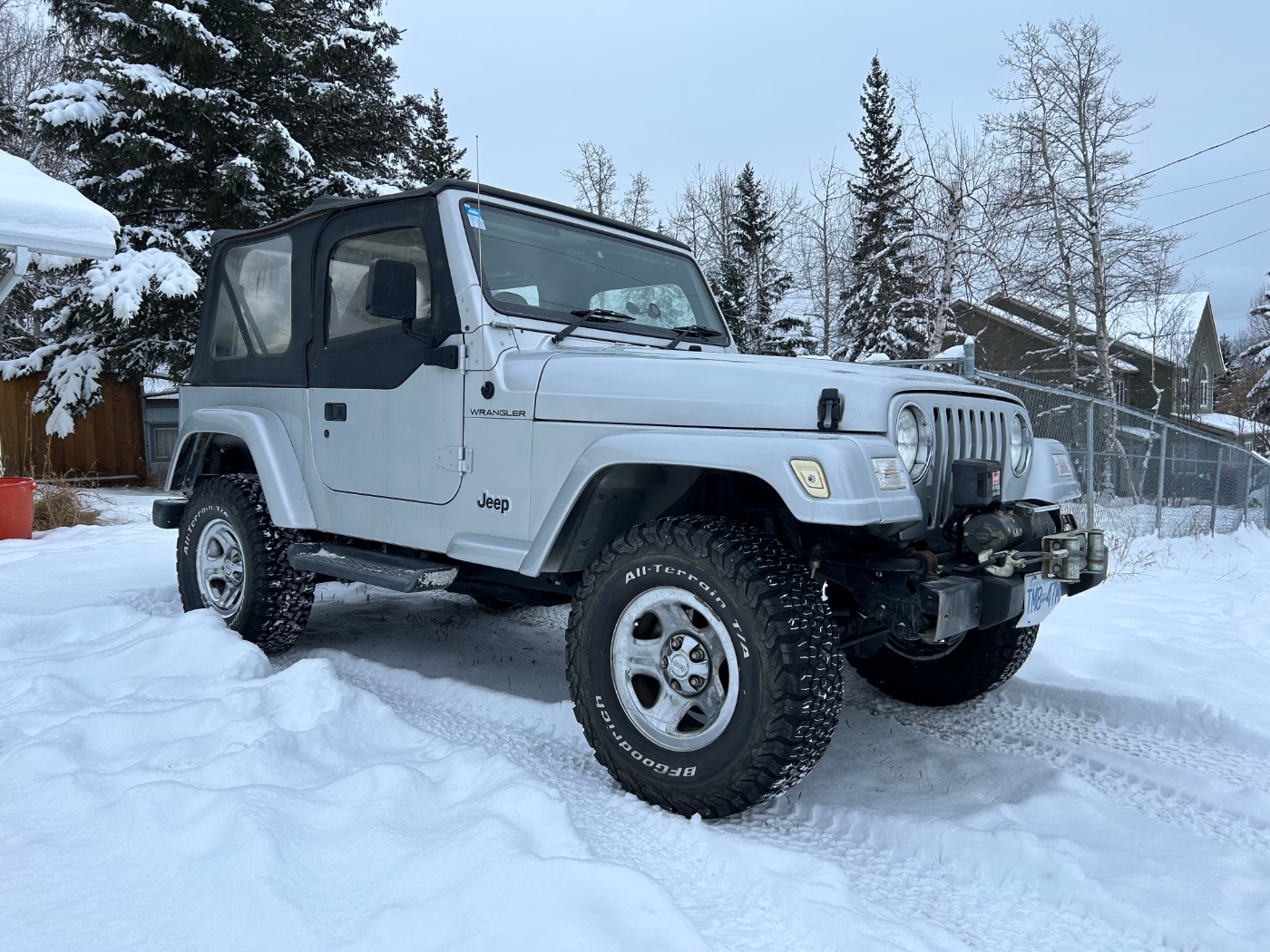

No real decent pics. But I’ve gotten out a couple times, this time the trail was a quad trail, so I took a whack of body damage. Learned that my ko2’s really suck on ice, had to winch a bunch because I refused to learn that my tires could be that bad, combined with no lockers.
. I think I’d like some limb risers, as much as I hate to admit it. But everything is pretty grown in and the window will take a pile of damage. Might need a front bumper with some fender guard as well.-

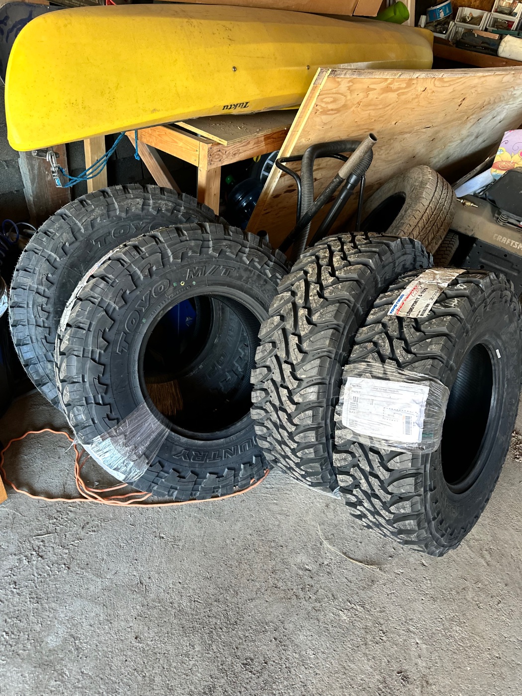

Tires showed up. 285/75r17 Toyo mt, c load rated which is rare for this size. I was looking up the China tires in Edmonton and they had these on a pretty good deal, good enough I couldn’t do the cheap tire thing. Without air they are 33.5” tall and 10.5 wide which set about where I wanted to be. Should be able to get decent wheel travel with the lift I have and not spend a bunch of coin at it. I also grabbed some rancho rs5000 shocks for a 3.5” lift which have about 10” of travel and are 1.5” longer collapsed than I have, so that means they are probably long enough to have a coil fall out on me.

They haven’t impressed me in the icy stuff for sure in the past but in reality I’m the snow the gladiator on 37’s will destroy the tj anyways and I’ll probably take that. The tj is mostly offroad, and close areas stuff. If I’m going hardcore in the snow I’ll either swap my gladiator tires over or take it. My biggest thing was a mud tire as they perform better up here even in the sandier areas, round, and reasonably tough/true to size and the Toyo hit all of those. Being c load rated was a bonus. One of the Toyo’s was with .25 ounce of being balanced on the factory gladiator wheels so they should drive decent.Scott Cee AKA 2drx4 wrote: ↑Wed Feb 14, 2024 10:38 am Hmm, wonder how they will do in snow. The Toyos have a bad rap, but maybe that's because they're all load range E normally.
